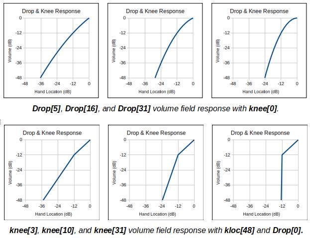

So the velocity unit now uses a 40Hz first order high pass filter to detect velocity, and the velocity is now applied bidirectionally rather than just for the attack, so it can also be used to more quickly drive the volume to zero. The day before yesterday I thought to position the velocity unit before the knee unit rather than in parallel with it, and after playing it for a while think it's a keeper. The following knee gains up attack and decay, and this - along with the higher cutoff frequency and bidirectional velocity - tend to hide the filter wind-up, so higher velocity settings don't cause large attacks to rail at max volume for a noticeable period, followed by a weird decay (having an RC exponential decay go through the EXP2 function at the end gives who knows what). Limiting the high-pass filter input to [-98:0] dB gives a nice range in the field (you don't want significant subsonic operation) and also prevents saturation of the filter output.
I considered having the velocity unit be the only input the envelope generator, but the knee provides the lion's share of attack sharpness, so it must somehow also be an input to the envelope generator, and can't bypass it.
So we can use the velocity to drive the volume level up through the knee and back down again, which seems like a good thing in practice. Having the drop before all this adds even more to low volume velocity gain, which I thought might be problematic but it doesn't seem to be. I think it's best to have all of these units in series if at all possible, as the simpler processing may feel more intuitive to control with the hand.
