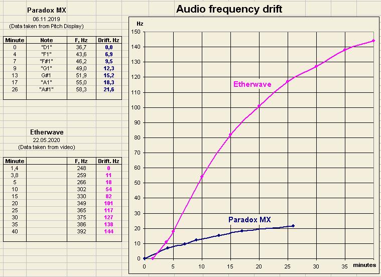

I do extracted the data from austin video and presented it as a graph.
If anyone is interested.
At the same picture I demonstrate the drift of Paradox MX which has air core coils.

Keep in mind that if Austin tunes the instrument to a low note (as I did in Paradox), the drift, expressed in musical terms, will be a few octaves!

Ilya, I did not notice such a large drift my MOOG ETHERWAVE PLUS...
Posted: 5/22/2020 1:14:14 PM
ILYA
From: Theremin Motherland
Joined: 11/13/2005
Well, I quite admit  that the drift varies from one to another.
