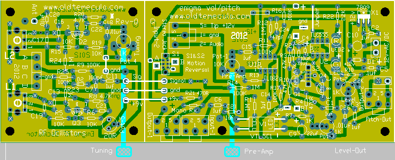

If I could "hire" you to look at this pcb layout and tell me what you don't like about the RF oscillator section on the left side, I have a clever way to pay you.
The detector is diode D2. I do have a higher voltage than in general across the emitter resistors. Everything works but I need an engineering evaluation, I have great even harmonics which I find to be more a function of the coils and their interaction. I may not listen to a thing you say but would respect it completely. (-'
I have private webpages this came from. I think I am ready to home etch this board again. Once produced commercially it will be given away, not because I have lots of $$ because I live on SS. I would order 50 for the price break but need only 10. I am on a journey.
Circuit Board   The graphic is a bit wide to display here.

Is there a schematic available?  I only took a peek at it today, but will give it a good rogering tomorrow.  Not promising anything, I'm not a Theremin expert, but two heads I guess...
Though I have looked at a bunch of RF oscillator designs lately (before I gave up on the whole notion of analog oscillators in Theremins).  They dead bug everything on single sided thick copper clad mounted in cast metal enclosures with big machine screws.  My Theremin prototyping analog front end breadboard is in an aluminum box with a UHF connector out to the antenna (UHF connectors are a natural for 3/8 tubing, much easier to set up and tear down than the mickey mouse plumbing fixtures on the EWS).  I wonder why Theremins are generally built on single or double sided PWBs with little or no shielding?  Is it an attempt to not capacitively load the sensitive circuits?  Seems like it's just asking for RF interference and thermal drift.

OK, I traced out the oscillator section.  Looks like a common base Hartley.  I don't have the capacitor values, but C13|C23|R8 seem to form a high pass capacitive divider.  1/10 amplitude resistive mixing to D2.  The oscillators may be coupling here.
20 ohm Pot-5 does what?  The common bias point might be coupling your oscillators - or is that the intended purpose, some kind of counter coupling to cancel out the mixer coupling?
I'd have to simulate to go further, short of that I'll probably never really know much more as I'm going down a completely different path.
Where do you hook up the antenna?

Pot-5 could be a 15 ohm resistor. I don't know why it does it but it takes the sharp edge off of audio waveform for a nicer sound. A slight bit of isolation to the RF board? There is a sweet spot between 0 and 20 ohm.
I do wish my coils were further apart for more pitch control but the real purpose of the board is stand alone volume control and that works excellent. This project has a special purpose.
Antenna connects in upper left corner where it says Ant. Thank you for looking.
