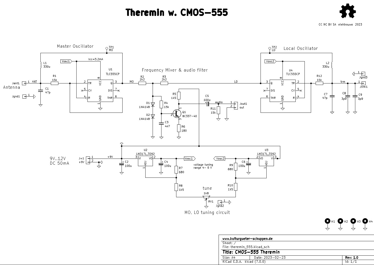

The picture below comes from the above article/blog which is closed for maintenance but should be availiable later sometime.Below is the circuit which uses 555 volume control for the theremin in the EPE 04 issue by Robert Penfold.I wonder if this could be adapted for the EW standard.It uses pulse width control to control current at about 25 khertz.

Looking at the schematic, I would guess that it is hugely inferior to the volume circuit already in the EW standard.
When I say "hugely", this is an extreme understatement - sensing range will be extremely limited, and linearity will be appalling.
Given the choice between Penfold and Moog, I would choose Bob Moog's designs any day! I really dont rate Penfold, wheras Bob was the master!
"I wonder if this could be adapted for the EW standard"
Simple answer - NO!

Do you think Bob Moog put expensive coils into his design if it was a "simple matter" to design a responsive linear volume control without them? Do you think that he just chose coils costing about $2 deliberately to up his costs, rather than using a simple 555 circuit costing <50c ?
I am not trying to wind you up here - Just trying to get you to think about the realities. I am not saying that no person will ever come up with a clever, simple way to achieve what you are after... But I am saying that the 555 circuit you presented is NOT CLEVER - It is rubbish, will have low sensitivity and appalling linearity - and its nowhere close to the quality of the design in the EW.
