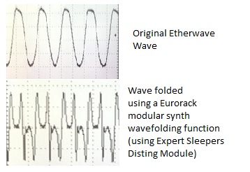

A wavefolder is a form of wave shaping that basically folds the edges of a wave inwards on itself until the wave starts compressing completely and then the folding can continue from there if desired. Different Wavefolders can create different folding compressions and also some let you modulate the symmetry of the folding. This is best explained though a picture or two, however, the end result is that the folded wave takes on a much more complex harmonic structure.
Wavefolding example #1
Here's the same wave that is starting a second fold, now folding upwards:
 Wavefolding Example #2
And here's the wave that had been folded a number of times:
Wavefolding Example #3
Each time the sound is folded, it becomes more complex. However, wavefolding is most effective when applied to simpler more sinusoidal waveforms with less harmonic content as the effect become more pronounced in this case as the harmonic content becomes more complex. This is exactly the kind of waveform produced by the theremin so it makes sense that the technique might be useful as a theremin effect, if not also useful to slightly alter a theremin's sound to give it a bit more "umpf".
