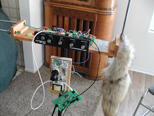

I am obsessed with the theremin CSB Hybrid concept as a means to stay connected to the authentic theremin past. There is a sound I like that is lost using a completely modern day approach.
With my gaining experience in hybrids I wondered what an EtherWave Standard mixed with a tube/valve would sound like. The design still needs some tweaking but could become a one-weekend add-on build project for less than $100 once everything is organized.
Fortunately the EWS never sounded like my grandkids on a toy keyboard synth but it is disappointing for me how the best theremin design available has a dull lifeless sound, even when the finest musicians play a tune.
The EWS Tube/Valve Hybrid responds exactly like a stock EWS, it just sounds more like an original classic.
Notice the green insulated wire fed through the volume loop, this prevents grabbing the loop contact and static discharge issues.
The two custom pc boards mount on opposite sides of the mic pole. I have an idea to cover them along with a switch to go from the expressive tube sound back to an stock EWS tuba sine whistle.

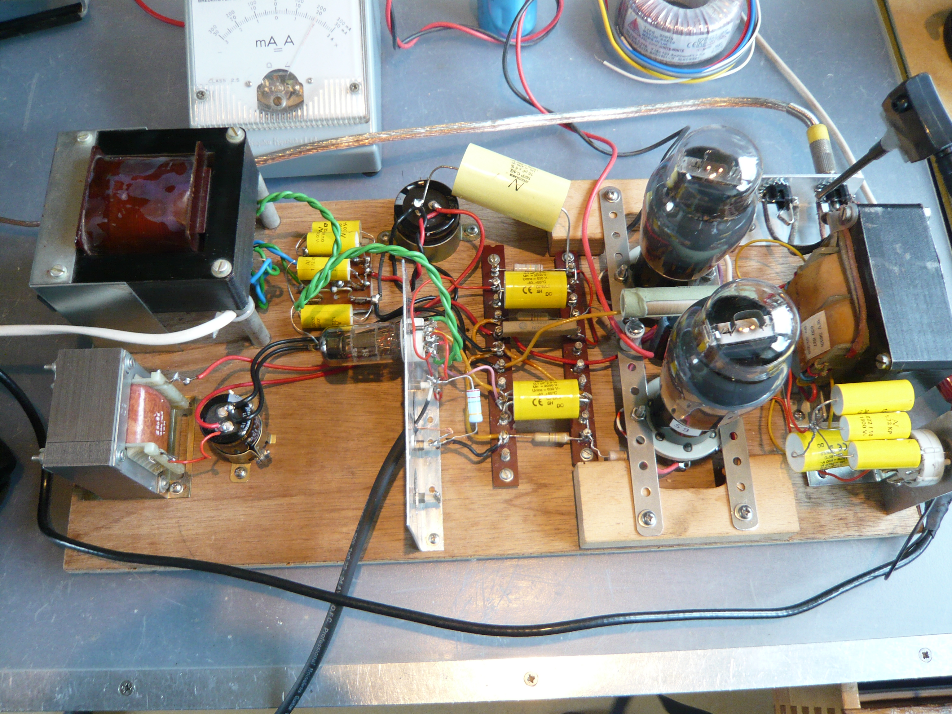

After finding four 59 tubes ( 2 used ones and 2 brand new) I decided to built a new amplifier for my Clara Rockmore theremin. As I didn't have a balanced interstage transformer I had to built a simple phase splitter before the two 59 tubes which worked out very well. I also added a crude tonecontrol by switching several capacitors across the primary windings of the outputtransformer so the sound becomes more mellow. I've put some photos in my Clara Rockmore Theremin replica photoalbum. At the moment I am trying to make some recordings of me playing the theremin and the guitar to make some MP3 files. But I still have to figure out how to post these files here on the forum,maybe someone can help

Here is a picture of my theremin amplifier prototype.The little toroidtransformer on the top is for the regulated powersupply for the heaters for the 59 tubes I still have to built. They are now heated by a Variac (5 Volt DC, 2 tubes in series). The yellow condensors on the bottom right are for the tonecontrol.
