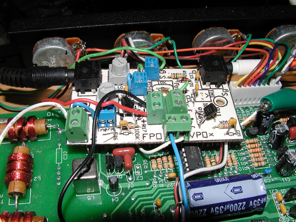

There is little room in the EWS box as the sides with the antenna wires must be respected. Here is a photo of my CSB mod, which is a Continuous Signal Breakout point. As I have said in the past Fred, Thierry and especially dewster influenced the approach seen in the photo.
My pitch is enhanced using an external board much to big to fit in the box. Not being a musician and not following YouTube there may be an easier method to get the sound I like, a fat opera sound, if so someone please tell me.
The audio is born on the CSB mod board by using a single diode to mix the RF, no detection, very simple, 9th grade stuff.
Here is my sound.mp3 which is authentic analog theremin in principle. My sound goes so low it just rolls over to the other side. No thereminist has ever told me this is a sound they could enjoy playing, my hearing is limited and family always says nice things. 0-:

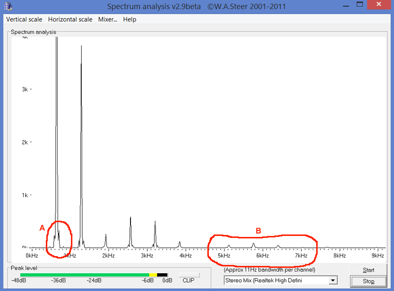

Edit: Now that aliasing was brought to my attention I think this graphic of the sound byte reveals what some hear and I never have, example B. The fundamental is about 650hz, in the vocal range. Five harmonics relate but not the right three. Should be able to clean that up if I get back into things.
Edit2: Further study shows all of the spikes are harmonics of ~560hz, the noise or distortion I can not hear might be represented in sample A, the fuzz around the base of the harmonic spikes.? This needs further study.

There seems to be the same unusual high frequency sounds in both files, so it's probably not a compression issue.  I think it may be low level RF noise modulating the signal at certain frequencies.  I am listening with "in-ear" monitors... so I'm hearing things very clearly. It's likely that some of these sounds that feel odd to me are not audible when listening with speakers.  It's all very subjective stuff.  I will agree about the Factory Etherwave tone, that it's too muffled.   The evolving harmonics are where the juicy lush interesting stuff is.  But different listeners will have different preferences as to what sounds pleasant.

Randy thanks for the input, I need to figure out a method to visually display what you hear. I may have a method already but don't recognize aliasing when I see it.
The roll-over is when the thread continues onto a new page, it gets my ramble out of direct view. (-'
PS: Look at our Avatar pictures, good thing it is not mating season, definitely different dinning taste. LOL
Edit: Think I figured out how to view this aliasing, I put a graph on the previous page.
