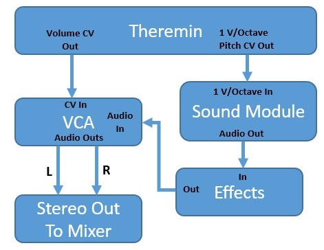

This is normally how I like to trigger the theremin in the modular environment - using Volume CV induced envelope instead of a gate or envelope generator. Sound module here is any oscillator or sound module that takes 1V/octave pitch control. The nice thing about this is you get the theremin's actual envelope so in effect you can have a zillion sounds controlled from that theremin that play just like you expect a theremin to play (in a dynamic pitch filed with portamento).

Yes! Pretty slick!  That's exactly how I envisioned one scenario. Thanks for sharing that layout!  Have you experimented with incorporating any sequences with your Theremin?
