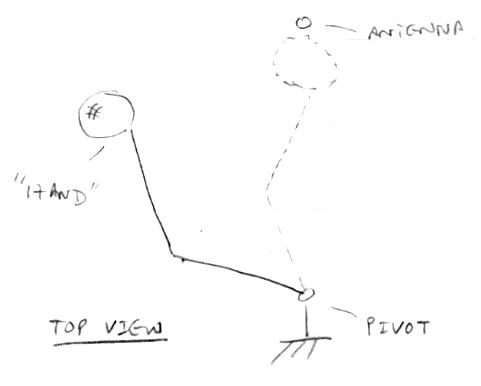

ILYA, for the "hand" paddle, I would use a roughly hand sized sphere instead of a plate.  This would simplify and make much clearer the distance measurement between it and the pitch antenna (the distance between the closest points of both).  I would also make the "arm" section long enough and maybe angle it (with a fixed angle) so that it could be located significantly behind the "hand" sphere for all measurements:

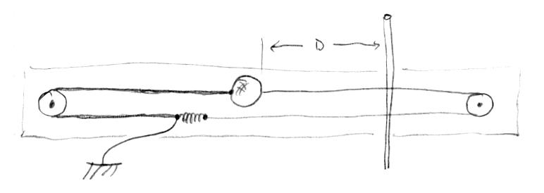

Putting the hand sphere on a string and pulley structure would probably give more accurate results:
That's a wire instead of a string on the left for grounding, and a spring between the wire and the string for tension.  Mount the whole thing on a plastic holder of some sort (not wood because it has to be near the antenna).  Make it long enough so that the spring always remains significantly behind the ball.
Or stick a really lightweight ball (xmas tree ornament, or Styrofoam covered in AL foil) on the end of a telescoping antenna and position it horizontally, which would be much more compact and portable.
It's not a real arm/hand or anything, but I think you would get fewer people arguing with you with this arrangement.  And you could always make a simple LC oscillator and calibrate the capacitance of the setup, and compare the results to my real and simulated arm/hand measurements to give confidence in the results.

Interesting string kinematics, dewster, but a bit more complicated.. It can be easily implemented using the same stepper motor and software as mine. Candidate number two to be tried out.
