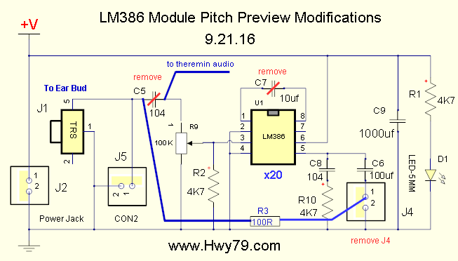

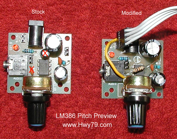

This small $2 LM386 board off ebay gives you Pitch Preview with volume control and a LED ON indicator. The good thing is the ear bud jack is stereo or TRS which makes it practical. To bad they did not supply the potentiometer mounting nut.
I use a 4-pin ribbon cable which plugs into my Harmonic Exciter board for a clean interface. This cable supplies power, the audio from the theremin and the extra pin when grounded will mute the theremin.

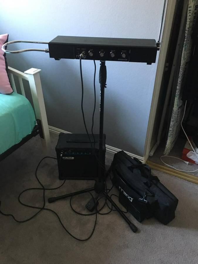

Keep an eye on Craigslist, there are many EWS in people's closets and there are very few buyers. I bought this complete mint condition setup below for $250 last month as I expect to give my original modified EWS away.
