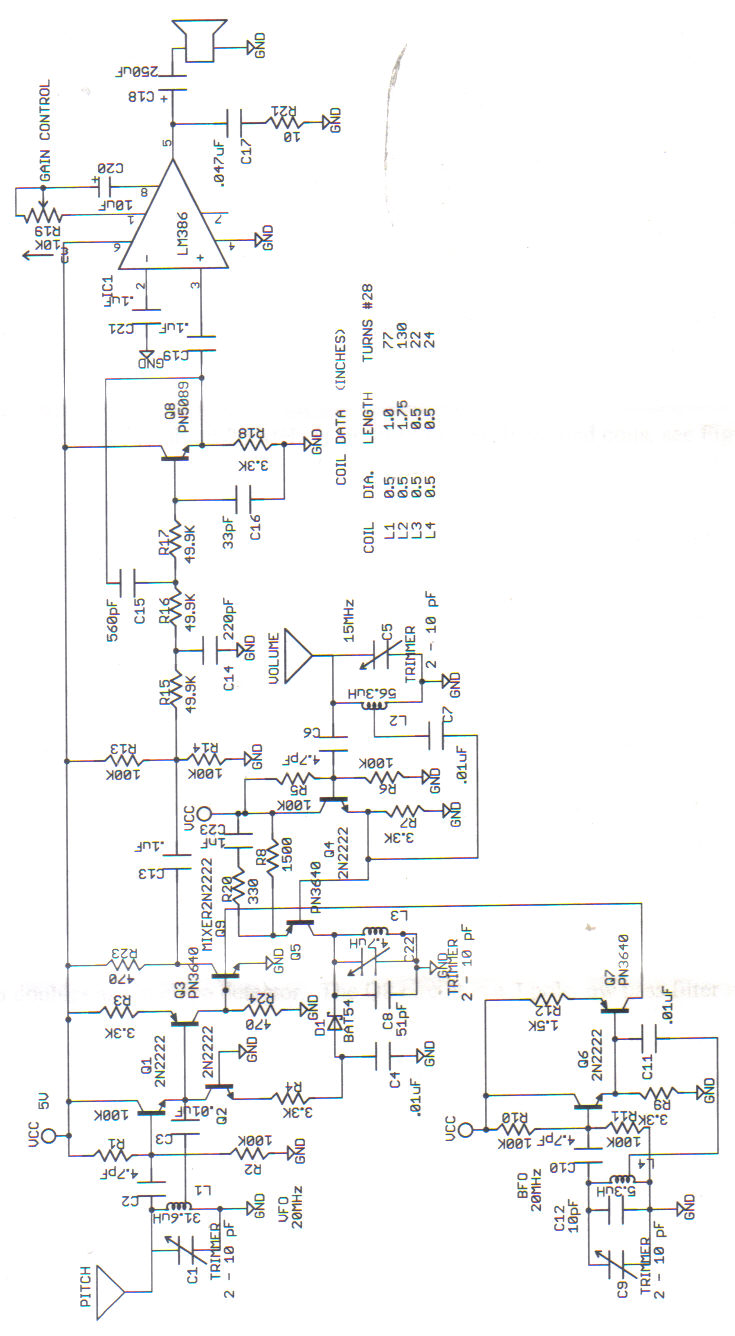

You'd need to access the transformer to make a lower voltage power supply (a schematic would be good to have).
Then you could build something like this inside it;

Wow, 20MHz pitch side and 15MHz volume side.  I don't think I've ever seen such a high frequency Theremin circuit.

Having the schematic makes it a lot easier. Just run the +-20V into +-12V regulators, build the
circuit and slap it into the case. Of course you will need to keep the coils away from the transformer.
I'm building the same circuit with a couple of tweaks.
