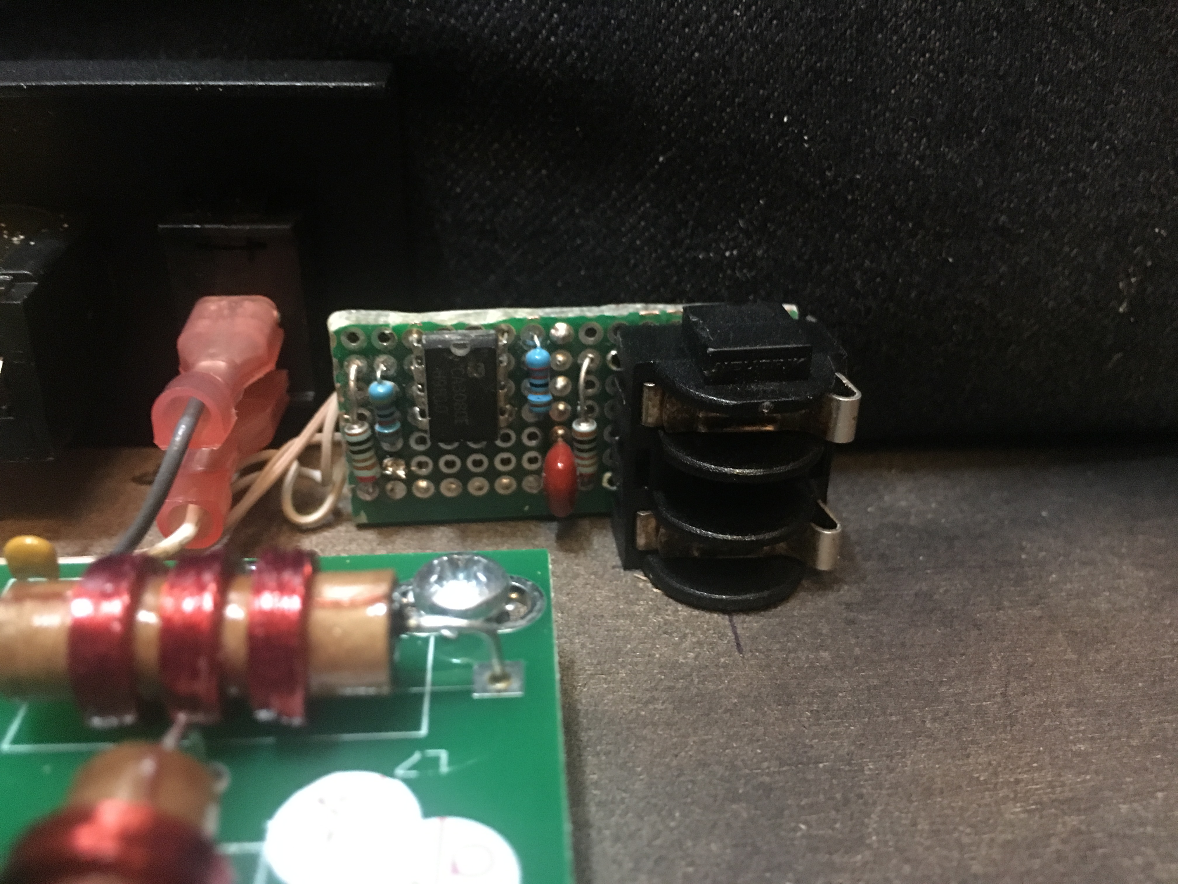

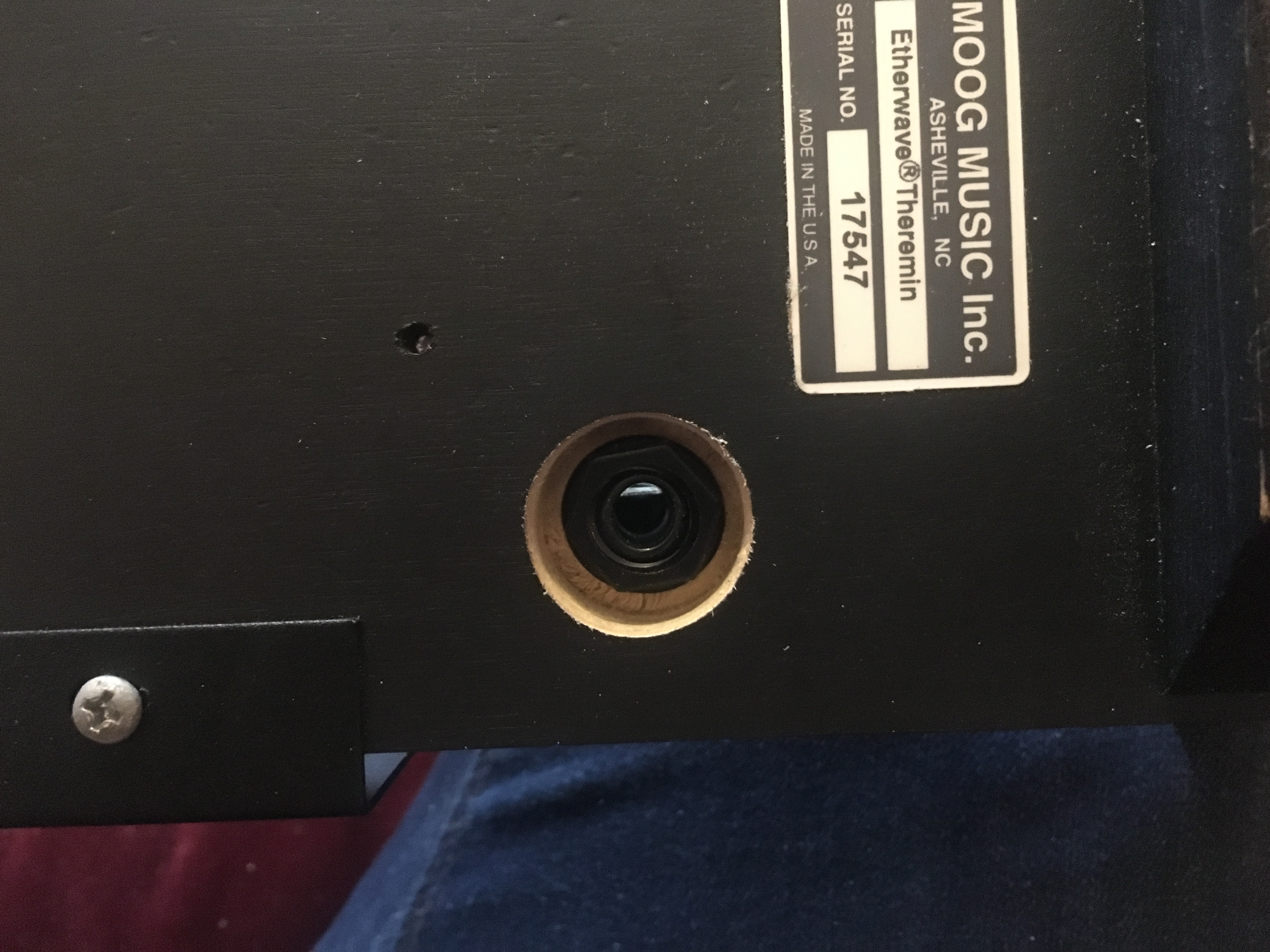

Posted: 6/24/2018 6:23:04 PM
Thierry
From: Colmar, France
Joined: 12/31/2007
Here is how I did it again today, still building Bob Moog’s original circuit around a CA3080 on some Veroboard:
Posted: 6/26/2018 12:56:48 AM
wannes_dn
Joined: 1/12/2014
very pro! That is how i have it installed to.
