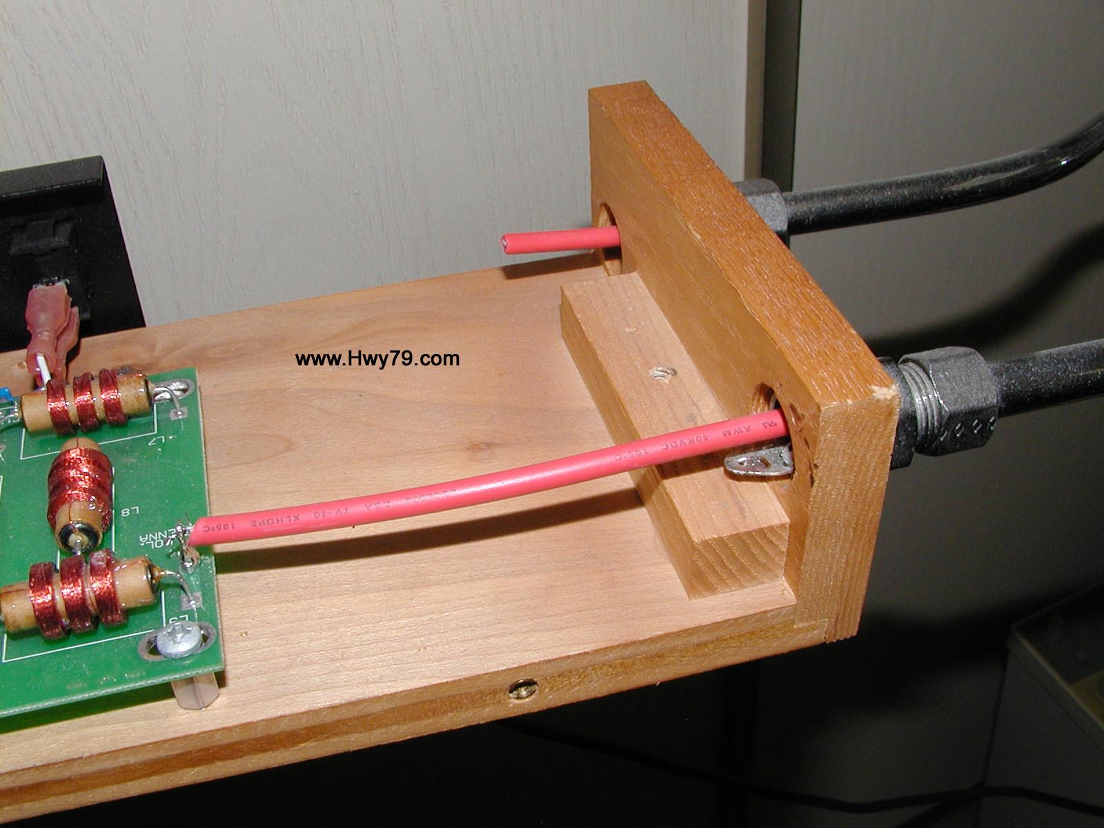

This method does work perfect , I found static discharge or ESD to be in the range of 8 kv to 15 kv, below is a very good remedy to avoid damage from this issue. Using the HV wire does not change the volume tuning or response, both remain the same as before the modification.
This method bleeds off the static charge into the atmosphere and it also eliminates the issue some theremins have from grabbing the volume loop.
http://Hwy79.com
Edit: The HV hot wire to chrome loop capacitance is ~3 pf, your original good volume sensitivity and tuning remain unaffected. The metal loop doesn't behave as a capacitor unless it is touched? A static discharge is dissipated about the loop, not through your circuit.

Didn't you try to do the same trick with pitch antenna?
Of course, pitch antenna is being touched not as often as volume antenna, but it's important to protect it, too.

I've ordered 40KV cable, so I'll test how this method works for both volume and pitch antennas.
