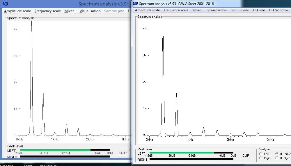

Valery, I rediscovered your graphs of our comparisons. This is very good we recognize when a sound is in the Classic Theremin ballpark, you will make our sound or Theremin's sound even better. Sound Sample1 is raw, no reverb to mask nastiness, the latest Phoenix build, completed this week, which will eventually be yours. Still have a handful of issues to work out. Sample2 is a little better I think… was probably done with my vacuum tube oscillators. Both methods use a 1N914 diode for mixing and detecting the audio signal, this area is critical but not really where the main magic hides.
