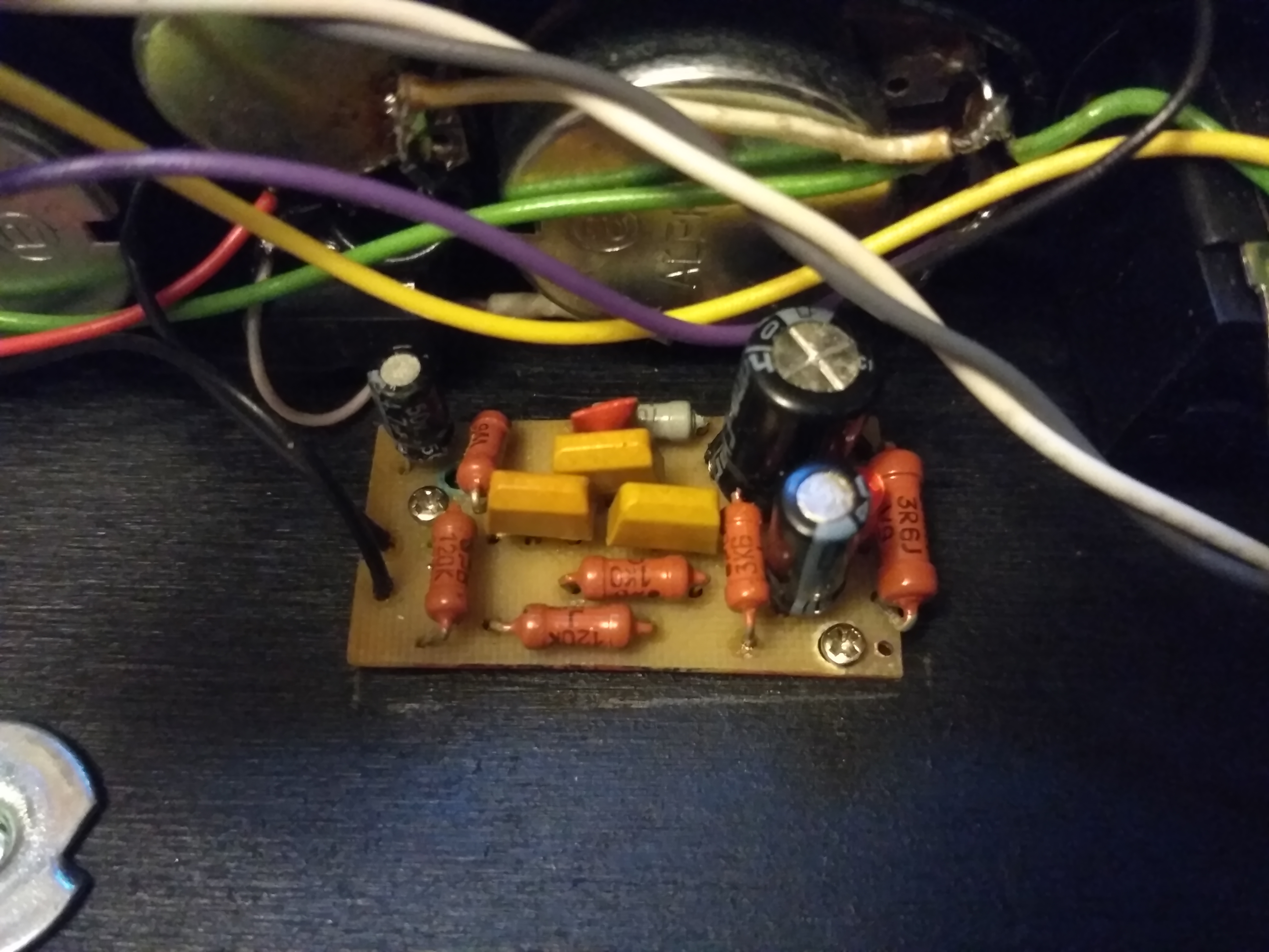

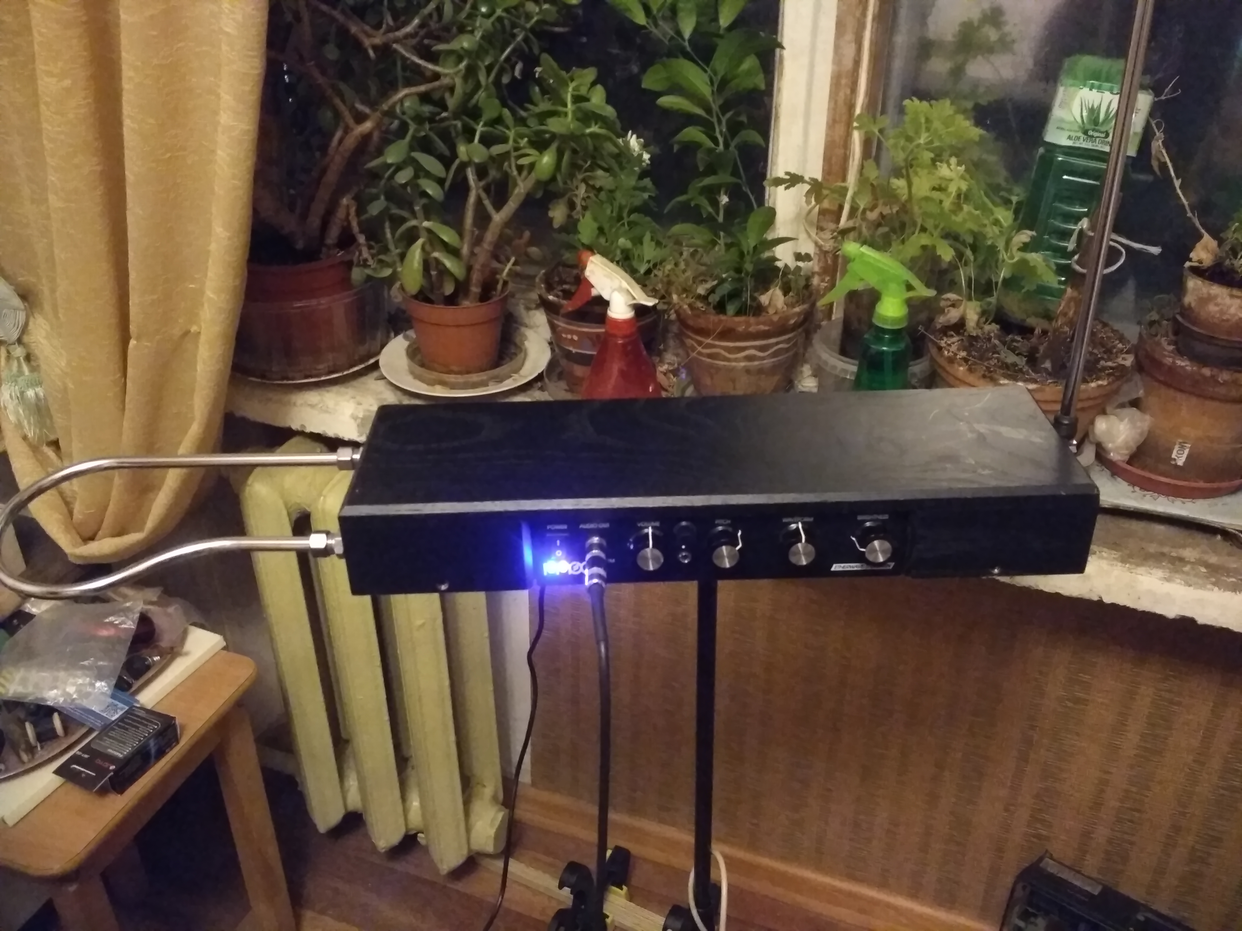

    Hello, nclm! If you use only headphones for rehearsals - you can use the audio output jack. For compatibility with mini-jack headphones, you can use the adapter 6.3 -> 3.5 mm stereo. If you mean a preview of the tone - you need to connect an additional headphone amplifier, which you need to mount into the theremin body and make it an additional volume control and headphone jack. I recently repaired the Standard and made such a changes. The appearance of the theremin was not affected. Although I added power LED indicators that fit well with the Termen Moog logo. (Media Album "Slightly "WRONG" repair technology.")
It’s not the first time I read about “tone previewing”, and I’m not sure what it means exactly. What does that refers too?
But yes, the modification you describe seems exactly like what I would like to do eventually! Is there are resource somewhere about how to make it? Is is entirely custom made or based on an existing amplifier?

nclm, I'm glad you liked my design. In the ETW standard there is no amplifier for previewing the tone. It must be assembled and added to existing components. Preview tone is necessary in order to constantly monitor changes in tone. And it does not depend on the level of the volume loop. You need to turn on the sound in the right places, hearing the right tone. The design of this small amplifier can be any. The main thing is that it worked well and was small. It must be built into the ETW standard box. In addition, on the front panel you will need a headphone jack for previewing the tone and adjusting the volume of this amplifier. I came up with my design and it takes up very little space inside.
