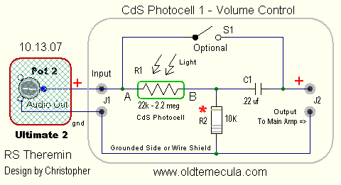

My simplest design is a finger volume control using an LDR light dependant resistor which is what turns many types of night lights on and off.
Use your finger, it is cost effective as the theremin you purchased will demonstrate how they work but you will not develop any useful skill from it.
The finger for $5 will give you better control than a volume loop.
