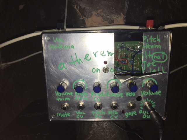

Posted: 2/5/2021 12:28:37 AM
satre
Joined: 2/4/2021
I was able to get my phone up inside and take some pics of the Theremin in there. You'll notice that the aluminum cover is cut open -- which allowed me to do more coarse tuning easier. Let me know if you recognize this kit. It works extremely well, just drifts a lot with temp/humidity (I know that's normal, just trying to find a more suitable alternative since I won't be there to do the tuning every day).
