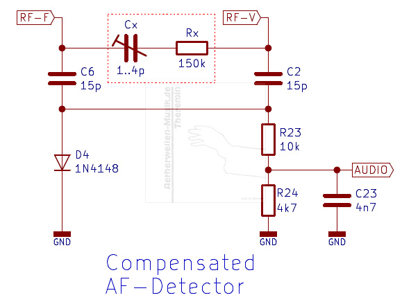

The Aetherwellen web site [LINK] by the amazing Alexander Klaus is a veritable treasure trove of Theremin mods.  I've been intrigued by the "Etherwave Standard Theremin simplest ever ‘Lower-Register’ Modification" (see Chapter 2) and a brave soul recently shipped their EW+ (Moog Music Etherwave Plus) to me to try it out.  The results and some discussion are presented here.
The mod is simple, indeed one can hardly imagine anything simpler: just a resistor and capacitor.  And the capacitor can be formed from two twisted wires if you are so inclined, making the mod pretty trivial component-wise.  Here is the circuit from the Aetherwellen web site:
Above: The mod is in the dotted box.
Basically all it does is couple the two pitch oscillators via the series combination of 150k resistor and small capacitor.  At first glance one might think that this could only increase the coupling and further aggravate things on the bass end, but that isn't the case.  A simulation on the Aetherwellen site demonstrates that it instead behaves rather like a bridged twin-T notch filter, which introduces sufficient phase shift and damping to extend the easily playable bass range.  The end result is similar to what the active buffering ESPE01 / YAEWSBM modules do, but much it is much less invasive and almost free.

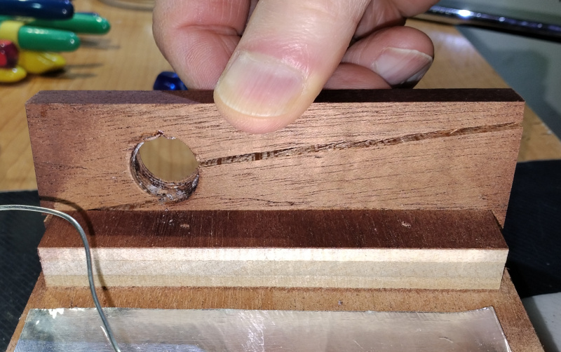

When disassembling the EW+ I noticed that the pitch rod plumbing knuckle was rather loose.  Closer inspection revealed a cracked side cheek, most likely from a previous fall to the floor (don't look at me).  Some Titebond III and overnight clamping fixed that, and coating the knuckle threads with 5 minute epoxy before reinstalling it arrested any free rotation.
Above: Cracked cheek.

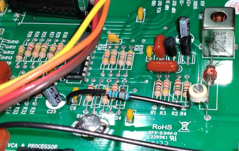

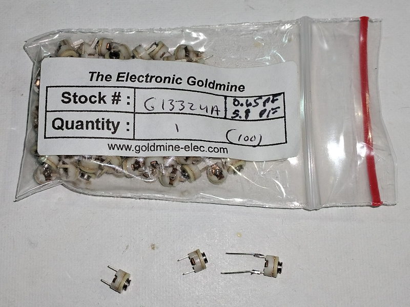

I think it's best to use a variable trimmer capacitor instead of twisted wires because it's easier to get the adjustment spot-on.  I bought a bag of 100 trimmers from Electronics Goldmine a while back for cheap, and as luck would have it they just happen to be a good fit for this mod.  My brand spankin' new LCR meter tells me their range is 0.65pF to 5.8pF (I'm loving this new addition to my Theremin workbench).

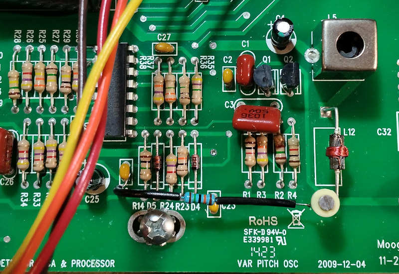

Above: Big bag o' trimmers.
The far leg of C2 is actually electrically connected to the near end of L12, which gives us a convenient physical attachment point for the trimmer.  And, depending on how solderable the near leg of C6 is, you may not even have to remove the main PCB to do the mod.  On this unit C6 was quite flush, so I had to remove the PCB and push the C2 leads up from the back with my soldering iron in order to gain a bit of clearance here.  A short section of insulation from some random hookup wire protects the resistor leads from accidentally shorting out to anything.
Above: Two views of the mod.
The brown/red/orange/yellow loose wiring bundle from the 8 pin expansion port on the main PCB to the front panel PCB travels rather close to the mod, and the mod itself is rather high impedance, so I zip tied the bundle together near the mod to help immobilize them (not shown).
