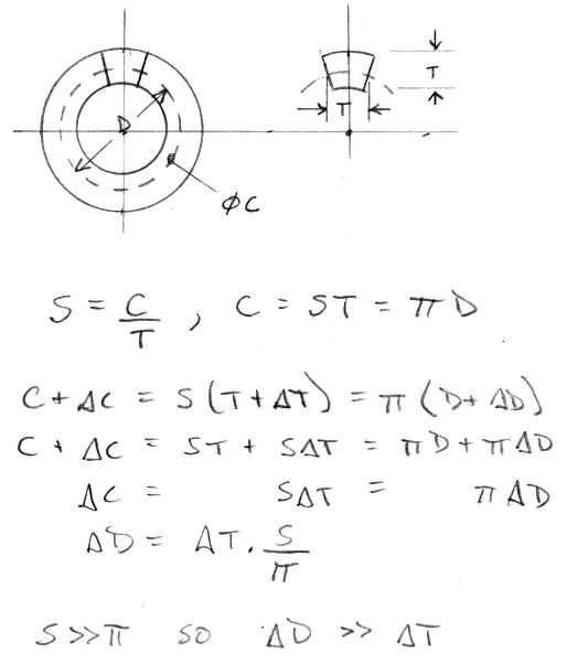

"Expanding copper will increase the wire length, which will (?) increase the coils inductance but I  dont see how expansion will change the effective former diameter (but here is where I am most likely to be wrong I think) as the expansion will occur on all axis, so as the wire lengthens it will also be getting thicker.. If the wire expands to a greater degree than the former, it will (I imagine) pack more tightly against the former as it heats up (?).. In which case it would be better to cool the wire (and former) when winding it (?)"  - FredM
I believe heating the wire (and not the coil former) should make it grip the former better when the wire cools, provided the coil former has a lower thermal expansion coefficient.
Here is my reasoning:
Imagine a ring made of copper, with thickness T and diameter D.  Now imagine we remove a section of the ring that is T wide forming a slug.  If we heat this slug it will grow by delta T in all directions.  This will increase the outer diameter of the ring by delta T, and will reduce the inner diameter by delta T.  But the ring is formed by a number of such slugs, the quantity of which is given by S.  From the math above I believe the overall increase in diameter will swamp the inner diameter decrease, particularly when the wire diameter is small compared to the former diameter.
[EDIT] I know the opposite (inverse? negative? contrapositive?) of this works from my years working in a machine shop.  We would super cool copper bushings (rings) that were made slightly oversize and stick them into bores in aluminum blocks.  When the temperature equalized they were really stuck together.

Thanks for that Dewster - I (sort of) see the reasoning with regard to a section of the ring (or nearly equivalent single turn).. But its this latter "nearly" which still bugs me a bit.. For a "closed" ring, I see it.. Expansion on all axis will cause compression..
But for a coil I still find the whole process difficult to visualise - ok - if we boil it down to actual numbers (I think copper has a coefficient of 16.6 ppm / K) the 'real' length / width increases are incredibly tiny.. but.. with a coil, I would expect the expansion along its length to be somewhat determined by the freedom of movement available to the wire (?) - Oh hell - I dont know!  ;-)

"But for a coil I still find the whole process difficult to visualise - ok - if we boil it down to actual numbers (I think copper has a coefficient of 16.6 ppm / K) the 'real' length / width increases are incredibly tiny.. but.. with a coil, I would expect the expansion along its length to be somewhat determined by the freedom of movement available to the wire (?) - Oh hell - I dont know!  ;-)"  - FredM
It does kind of come down to freedom of movement. [EDIT] I guess what I mean is that you are certainly correct in thinking there are two competing effects at work, but the one that shrinks the coil diameter with increasing temperature isn't the dominant one when it comes to the average inductor.
Instead of a ring, it's probably easier to think of heating a long thin wire that is S in diameter and 1000 S in length.  The wire diameter will only expand delta S whereas the wire length will expand 1000 delta S.  Connect the ends together to form a ring, and the (+) ring inner diameter change due to the wire length change swamps any (-) ring inner diameter change due to the wire thickness change.

"Instead of a ring, it's probably easier to think of heating a long thin wire that is S in diameter and 1000 S in length.  The wire diameter will only expand delta S whereas the wire length will expand 1000 delta S.  Connect the ends together to form a ring, and the (+) ring inner diameter change due to the wire length change swamps any (-) ring inner diameter change due to the wire thickness change." - Dewster
Agreed.
What follows might be utter baloney - I am just floating my incomprehension or doubts.. So not only is everythin that follows "IMO" - its "This is probably just nonsense!" (TIPJN)  ;-()
My "comprehension" has no difficulty when thinking about a length which has no constraints on its movement / expansion.
however, if one has a straight length of 1000*S, and rigidly fixes this at intervals of say 100*S so that the movement is constrained at these points, one will (?) get a degree of 'buckeling' or distortion in each constrained section? - if one takes a 3d perspective on this, and simultaniously constrains movement on any axis, the distortion will be forced into any free space available..
My imagination / visualization of a coil rigidly bonded to a former leads me to "see" the "packing" of the windings becoming tighter as a temperature increases.. Its almost, I think (?) an inverse of the way you have presented for a straight unconstrained length.. The resistance to change in length will (?) be 1000*S if one compares this against bonding resistance to expansion of S.. the cumulative bonding strength (and therefore resistance to length-wise change) will I think cause the actual change in inductance to be much lower than one would compute if one took the thermal expansion of a straight unconstrained length and converted this to increase in turns.
One cannot stop expansion - the thermal effects must present in some mechanical manner.. But my mind cannot construct a simple picture of what goes on with a coil... And it certainly cannot see the expansion resulting in a tidy proportional linear increase in coil length /number of turns/inductance.. I can see this as more likely if one lubricated the winding and the expansion was free to 'distribute' without distortion over the entire length (although, even here - what happens to the expanded wire at the ends, and whether this increases the effective turns, is I think going to be determined by the construction.. If the pick-up points for the starting / ending winding are placed so that increase in length does not translate into increased turns, for example)
