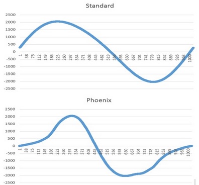

Let's take the Open.Theremin case. Here's the Standard wavetable and a wavetable they say is based after the Keppinger theremin. Well someone took the time to try and figure out what the basic wave shapes should be here - because with the digital theremin you absolutely must know about this subject unless you just want to experiment - and that's fine too.
Open Theremin  Uno Wavetables
If my goal is to create acceptable theremin simulations to create mockups of pieces, I need to know what's going on here.

Don't forget that any "good" theremin has, like an acoustic instrument, a timbre which varies with the tone height (pitch) and volume. Best examples are the RCA and Clara Rockmore's custom built instrument by L.T. himself. That's why up to now, most transistorized and almost all digital approaches fail in creating a vivid, organic sound.

Yes. Thierry. For sure. That's a major issue and why wavetable synthesis is possibly the "wave" of the future here so to speak. Not a static sample table as in the case above but a dynamically shifting multi-dimensional table that organically changes sound in response to different stimuli as some of the more modern wavetable synthesis engines work. As pitch changes you could start moving to a new matrix in the multi-dimentional table (in the modular world, a variety of CV inputs can do this). Now a Arduino UNO may not be up to this task but I'm sure some hot DSP would be and integrating some flexible dynamic filter controls would help a lot too as even my iPhone running Animoog can get some incredible sounds. There is a lot going on in the modular synthesis world today that may well be applicable to new theremin sound engines.
Also changing the "shape" of the sound in the modular world is not that difficult by applying dynamic CV control to a filter that a theremin sound might be run through. As long as the thermein has CV outs, variety of sound is more a $ issue than anything else. Maybe it sounds like a theremin for some settings, maybe something quite different for others. But I think it's time that theremins vastly open up the sonic space they traditionally live in.
