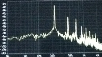

Even just looking at the the Burn's pro - which has a more sine-like sound - it's obvious it's not at all just a sine wave (this is just from my iphone sampling a fixed theremin tone at ca. 220 Hz - just a fixed object in front of the antenna so there is no vibrato on it)
Spectral Plot
I suspect you could get a decent thermein-like sound just by adding up the first 8 or so harmonics in a relationship like this. Maybe throw a random number generator at slightly changing the harmonic amplitudes over time. But to get it to really sound like a theremin you will have to add the right envelope, vibrato, etc. As Thierry points out the spectral shape is dynamic, but frankly I think you could create many waveforms that might sound very much like a theremin if you played them correctly - and that's more your csound problem. How do you get that slow but yet distinctive ADSR shape? How do you impose a variable and musical vibrato that makese sense. Without that it's just an oscillator without much character if you ask me.
