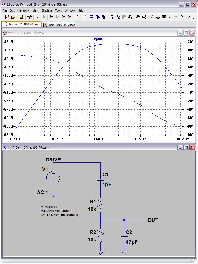

Yesterday I spend a lot of time breadboarding various methods to sample the LC tank signal. I generated a square wave via the FPGA NCPD and controlled its frequency via the command line. Buffered this with a single 74LVU04N inverter, followed by a simple bipolar driver (NPN & PNP with no crossover distortion amelioration), with a fixed 10pF in place of the antenna. Its nice to finally have a signal generation source that can go significantly above 2MHz (the limit of my function generator).
I was using a capacitive divider here to knock the signal down in the past, followed by a FET or NPN follower. I found that the capacitive divider could drive a fairly low resistance (~20k ohms) without noticable phase shift, which makes sense because the capacitive reactance of a 47pF capacitor at 2.2 MHz (tank resonance) is around 1.5k ohms. So I figured I could maybe do some high / low pass filtering at this point with an RC network. Played around with topologies and values while watching the phase of the drive vs the phase and amplitude of the network output on the scope, and settled on the following, which I spiced this morning:
From the AC plot, we can see the attenuation is around 34dB, which is a factor of 200. We also see the phase shift is zero at the LC resonance frequency of 2.2MHz, and that the filter cutoff points (-3dB) are around 300kHz and 15MHz. The cutoff points could be moved in somewhat, but not too shabby results for just dinking around on the breadboard.
Still debating what to buffer it with, but it will likely be a transistor feeding another inverter. I feel kind of weird knocking this huge signal down and then jacking it back up again in order to measure the phase with low voltage circuitry. I wish there were some way to deal with the large signal directly and limit it somehow, it looks really pure and clean on the scope before I start messing with it.

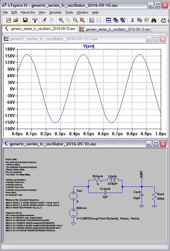

Yesterday I was trying to test various tank buffering topologies in simulation, and realized that the source had to be a real (simulated) LC oscillator. So I spent several hours today designing a generic series tank LC oscillator, which pulls together a bunch of stuff I've used in the past, and some new LTSpice techniques I've just learned:
The sim uses a B source as a current controlled voltage source, where the reference current is the tank inductor current, and the output is limited using the LIMIT command. A second zero volt source is in series with it for AC analysis stimulus. You can set the min and max voltage drive values, as well as the transresistance (gain) of the B source. There are parasitics you can set for the tank inductor and antenna capacitance, and the initial "kick" (to get oscillation up and running quickly) is provided by an initial inductor current condition. Two transient simulations are provided, one from time zero to check for steady state (actual oscillation rather than just ringing from the "kick"), and a detailed end-point sim which measures the frequency of oscillation. The AC analysis measures overall Q (which is influenced up to a point by the transresistance). Measurement results may be found in the Spice error report.
Spice file here: http://www.mediafire.com/download/7cd63234dfxc5fr/generic_series_lc_oscillator_2016-09-10.asc
[EDIT] It turns out the HP/LP filter shown in the previous post is something of a Q killer (Q=26.8), so I guess it's back to a simple capacitive divider (Q=38.7). Also, I tried to use the current through Cant as the feedback, but couldn't get it to work for some reason.
