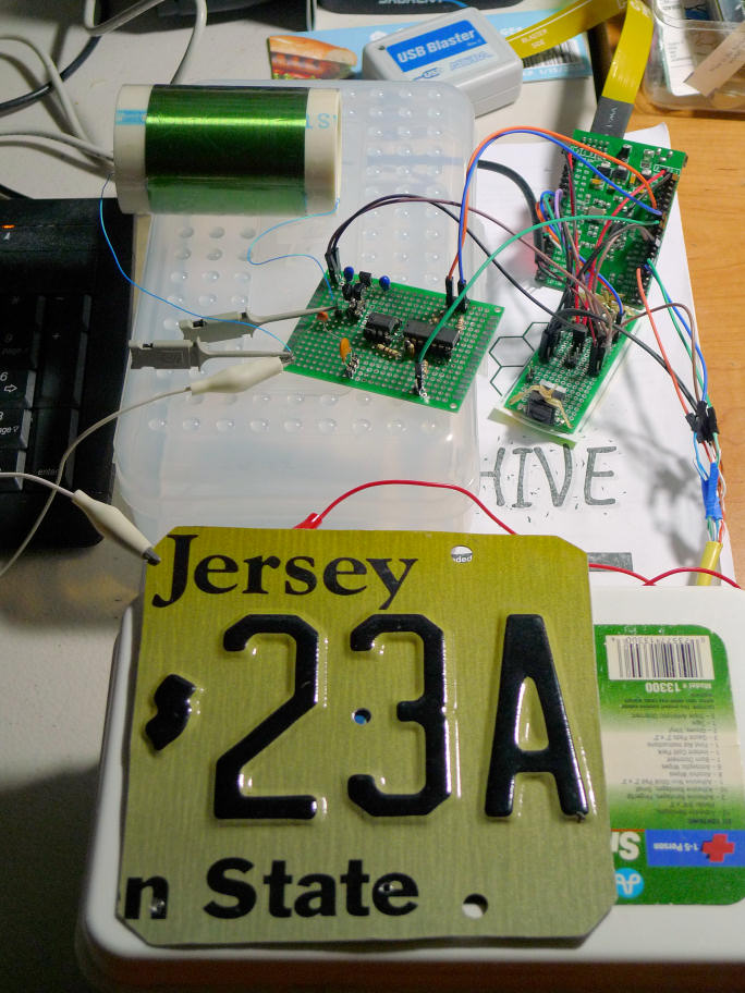

Volume Side Experiments
Since I'm seeing a range of ~2.3MHz (nominal) to 1.4MHz (hand on box) on the pitch side, I decided to set the volume side nominal to somewhat lower than this, 1MHz seems like a good target.  2.3MHz on the pitch side works out to ~14pF of antenna capacitance, and the volume antenna area will be somewhat smaller, so a ~2mH coil seems called for.  I didn't have one handy so I wound one today.  I cut an 80mm length of 1 1/2" PVC schedule 40 pipe and wound about 250 turns of AWG 32 on it, removing turns until my LC meter told me it was 2mH (thought the target is crude and this level of fussy isn't really called for).  DCR is around 22 Ohms.  Then the usual wire wrap wire leads, clear nail polish to secure the wire ends, and clear battery heatshrink on the outside to protect it against dings and such.  Hooked it up to the rewired (now single channel) volume tank driver board and hooked this to the FPGA board. Using a 1/3 license plate antenna for initial testing, the final plate should have a bit more area:
It resonates just below 1MHz, so I hit the target pretty well, at least with this plate.  Separated from the pitch antenna maybe half a meter, I'm not seeing any interference on the pitch side.  See a tiny bit on the volume side with my hand a couple inches from the pitch antenna, but it probably won't mean much in the final deal.  I'm watching this stuff on the scope via an unattached jumper wire, so the interference might not even be real.  Or there might be interactions I can't readily see on the scope that will pop out via pitch and volume playing, though I kind of doubt it.
First time I've messed with two oscillators at once via FPGA and it seems OK.  Now to make the real antenna plate and stick it all in the plastic box.

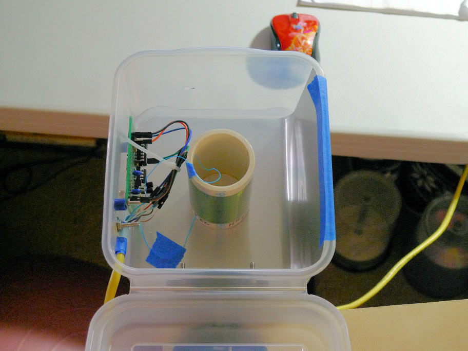

Volume Side
I cut a piece of aluminum flashing for the volume side plastic box and affixed it via nylon screw and masking tape.  This gives a larger area antenna which is good for sensitivity, and having it curve around the side means those who are used to the volume plate on the side may find it easier to play.  The PWB was affixed with two screws on standoffs cut from a discarded ballpoint pen.  The coil was attached via friction fit to a knockout plate with a hole in it, itself attached using the same antenna screw through the middle.  A strain relief cable tie keeps things stable:
Above: Again I used a bit of masking tape to keep the coil wires from vibrating, and a nylon cable tie keeps the interconnect wires stable and away from the coil.

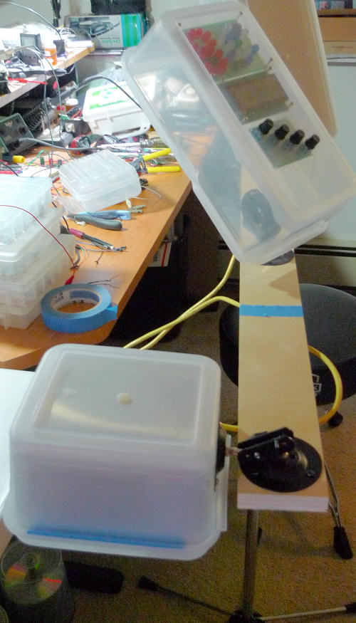

Above: Here it is in position on the board & mic stand.  I've since located the ball joint base to the bottom of the board in order to position the volume antenna somewhat lower, this feels more comfortable to me.  Desk is a mess as usual (I'm kind of a pig).
I'm seeing ~1.05 MHz nominal and really healthy voltage swing.  This arrangement seems to be working really well so far.  Now I suppose it's time to start stuffing the FPGA board and related circuitry into the central control box, and get the software show on the road.

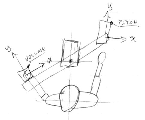

Posted: 10/21/2016 6:03:19 PM
Hi Roy,
To define the axes on my prototype a bit better, I present this crude sketch:
Call anything vertical (up out of the page here) the z-axis.  For comfort and control, I'm thinking the left hand elbow will be at or near the body most of the time, with volume work done mostly by vertically pivoting the forearm at the elbow.  This makes the left hand x-axis movement perpendicular to the pitch antenna, so the volume hand x-axis is pretty much the pitch hand y-axis.  Similarly, the pitch hand x-axis is pretty much the volume hand y-axis.  This is in terms of influence on the respective antennas, not direction, if you see what I mean.
I'm thinking some kind of twisting of the left forearm (& therefore the hand) might be the most natural movement for the second axis, but I'm not sure how to make that work with two simple antennas.
Maybe something like a half axis in the negative x direction of the left hand, where the hand would have to be somewhat to the left in order to make a difference in timbre (rather like the Roland joystick which has +/- x but only +y) ?
In both cases, the differential antenna distances won't track with volume movements unless the hand is moved at an angle rather than vertically.  Perhaps I'm making the mistake of thinking left hand axis separation should be entirely a hardware thing, and underestimating what can be accomplished mathematically in software.
