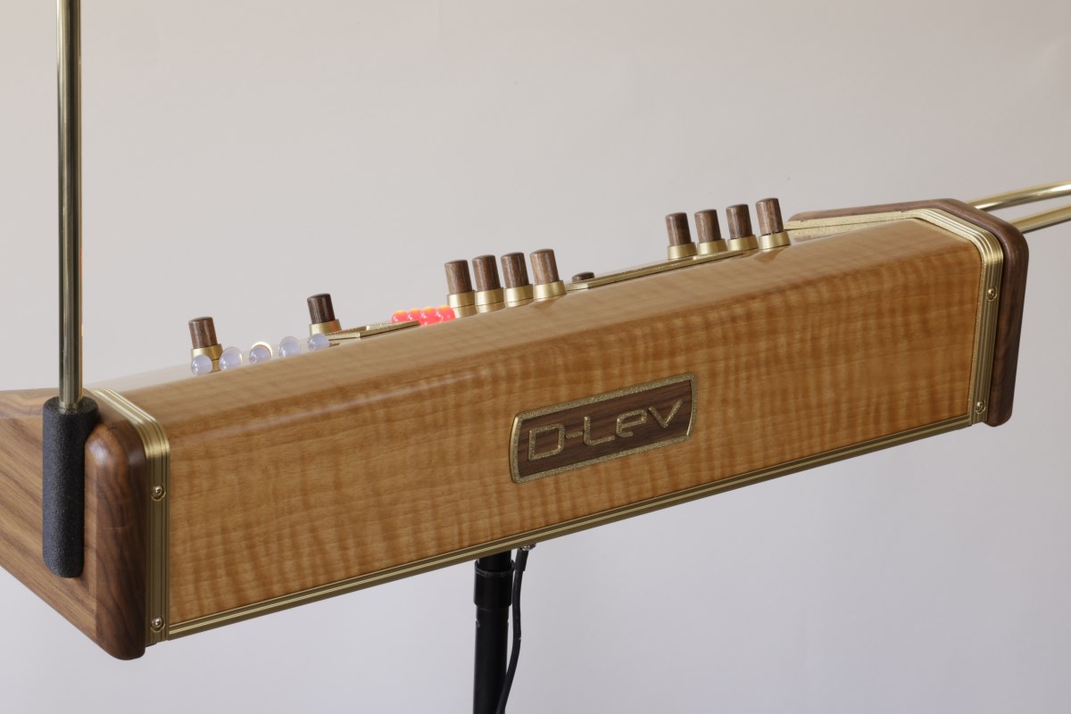

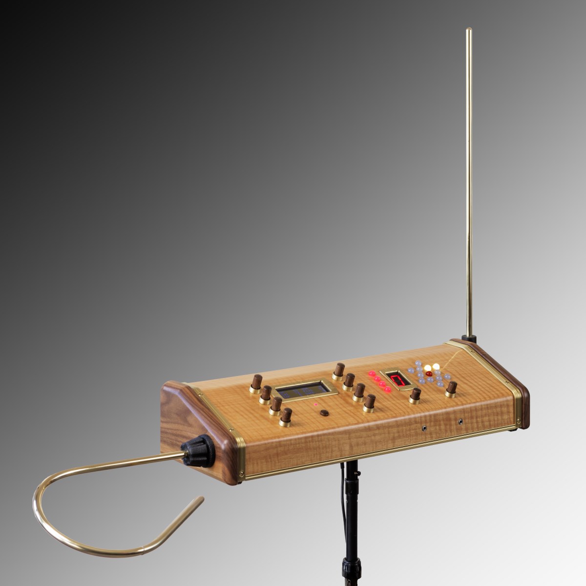

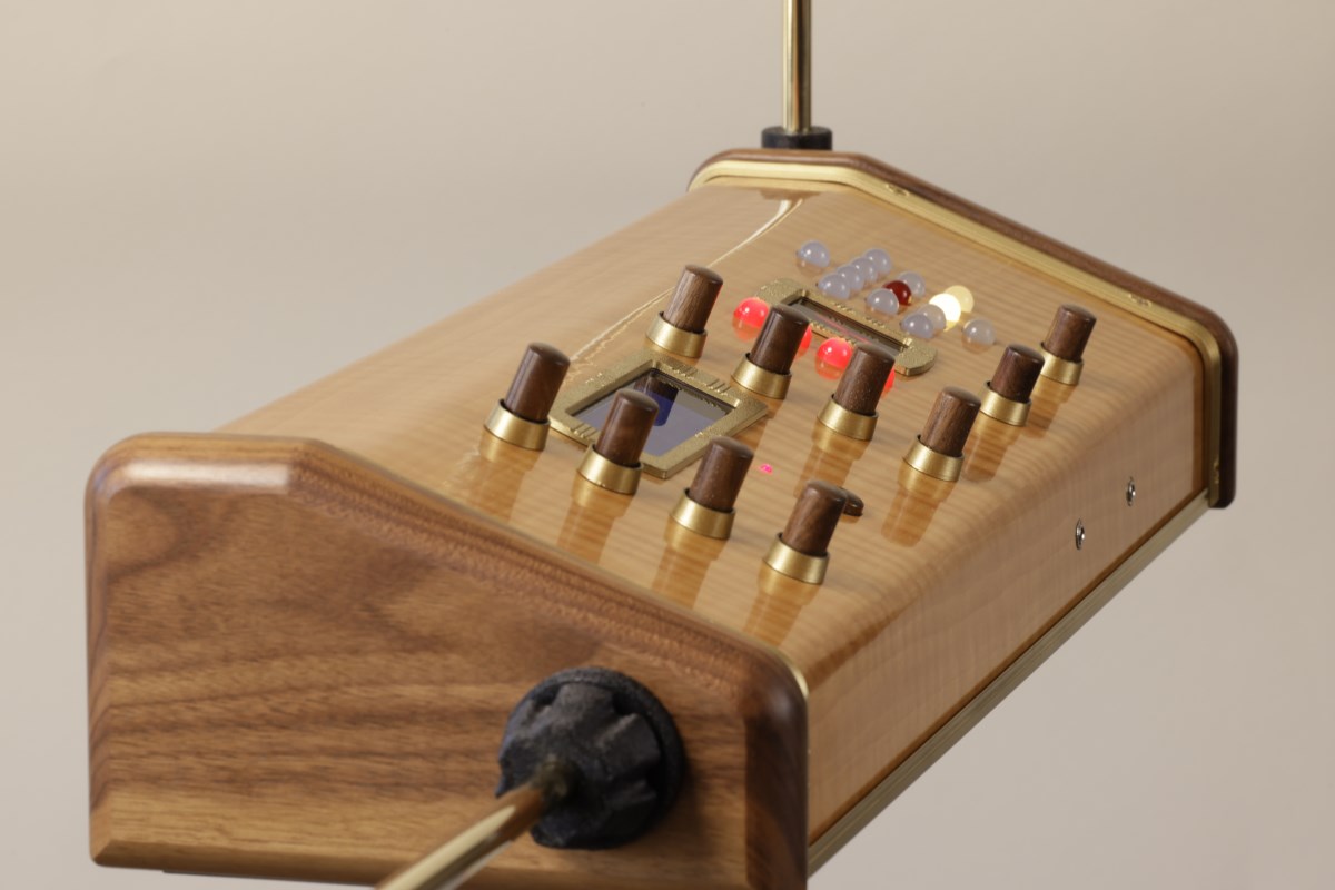

"This is the latest and maybe the last P3 model D-Lev that I built for myself using leftover parts. I wanted to try a wood panel look so I veneered one of the shells with flame maple and made wood knobs and a logo to go with it."

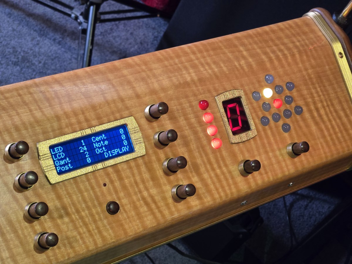

Your fourth image shows a remarkably smooth surface, which must be difficult to get with such a highly figured veneer.
"The antennas are solid brass but all of the other brass colored parts are 3D printed."
Beyond the antennas, I was wondering what was brass and what wasn't. The plastic (PETG?) parts are a bit lighter, but look amazingly like brass! I see you added a trim strip at the bottom edges to conceal the ends of the veneer, nice touch! Pretty Deco flair too (which you've been aching to do for a while now)! I wonder how you made the logo - by gluing individual letters and trim to the wood backing?

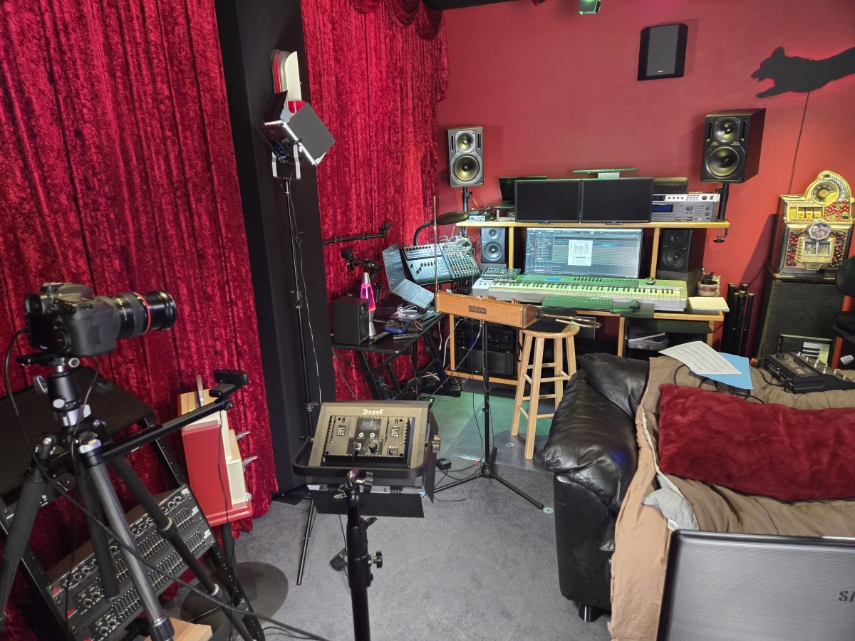

(Cool seeing the video recording setup too!)
