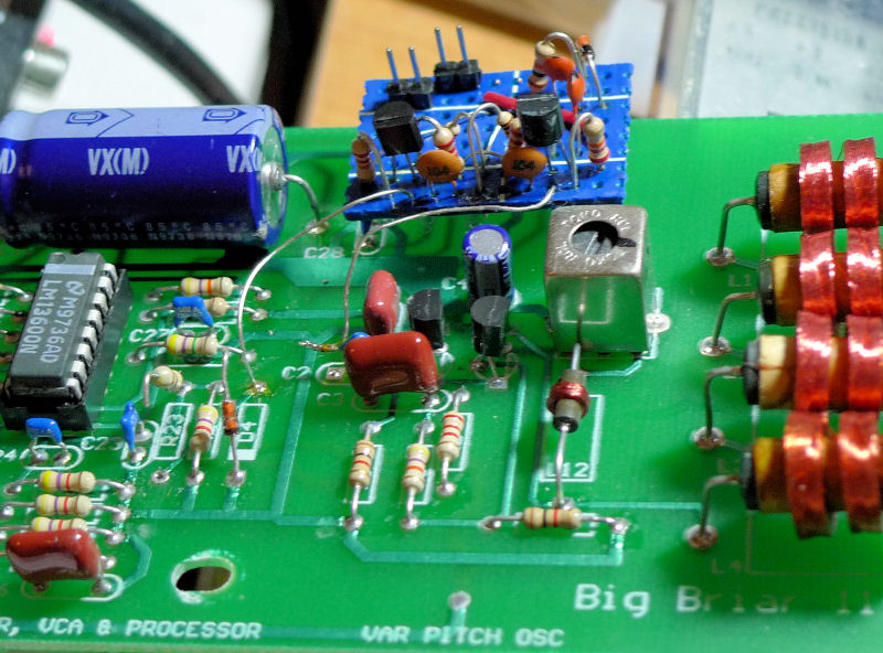

YAEWSBM v2.0 & Big Briar
A local Thereminist wanted me to install either the ESPE01 or my YAEWSBM module in his Big Briar Theremin (a precursor to the Moog Etherwave standard).  I'd installed ESPE01 modules in two of his other EW's, one a standard and the other a plus.  He was out of ESPE01 modules and I wanted to update the YAEWSBM, so this seemed like a good time to kill two birds.

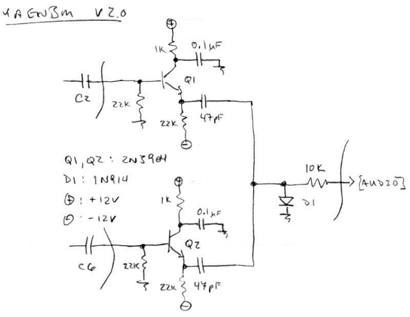

Here is the schematic:
As you can see, the collector supplies have have been bypassed with 1k / 0.1uF as recommended earlier in this thread by FredM.  The emitter trimmer is gone, and the impedances have been lowered a bit.  Since the header includes a connection to the mixer [AUDIO] I decided to replicate the mixing diode and 10k resistor on the YAEWSBM PWB, which increases the part count by 2 but gets rid of a jumper wire back to the main PCB.

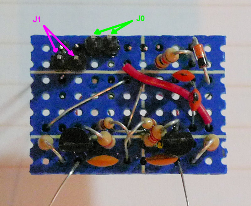

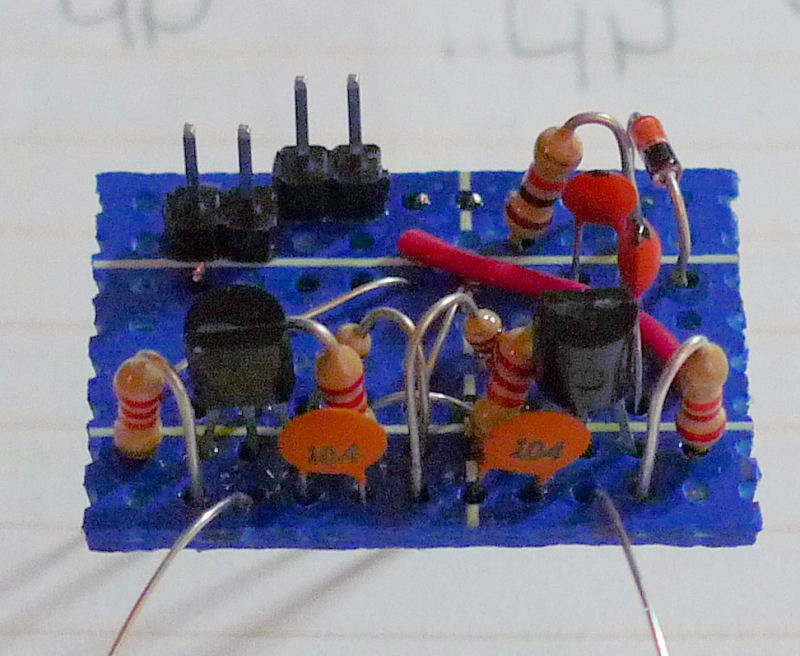

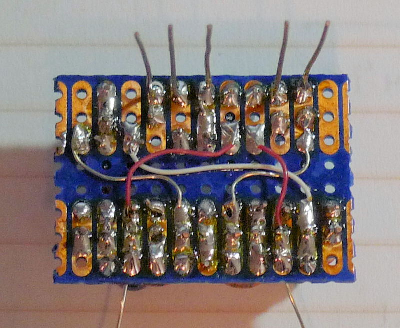

Here are three views of the YAEWSBM:
I used 26AWG tinned bus wire as the ground wire on the PWB, and as the fly wire connections back to the PWB.  I used a bit stiffer 24AWG for the connections to the main PWB header.  The colored wires are wire wrap.  Steel wooled the copper clean, and used liquid rosin to give nice solder wetting.
J0 is for a jumper, it shorts the transistor bases together to return the oscillator coupling should you want that.  J1 shorts the header [VCA OUT] to ground, which bypasses the volume section and makes it a pitch only Theremin for tuning purposes and the like.  And putting a DMM on J1 allows you to see the VCA voltage as a guide in aligning the volume side.

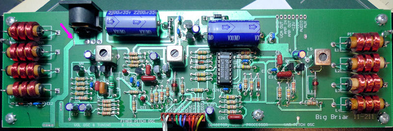

Here the top side of the Big Briar EW PWB prior to installation:
Note the header at the upper right with [GND], [VCA OUT], [AMP IN], [AMP OUT], [-12V], [+12V], [AUDIO], and [AUX] pads.  The YAEWSBM connects electrically only to the [GND], [VCA OUT], [-12V], [+12V], and [AUDIO] pads.  Note also the arrow pointing to the cut in the wide power trace at upper left - I didn't do this, and I think it may have come from the factory this way.
Here is the YAEWSBM installed:
The Big Briar PWB is laid out a bit differently than the EWS, in particular the fixed oscillator capacitor C6 is located way over on the left side of the board. I decided it was easier to lift the near end of R23 and the far end of D4 (which are replicated on the YAEWBM board anyway) in order to isolate the C6 trace.  I lifted the left side of variable oscillator capacitor C2, which is hiding here right behind the center orange cap.  The fly wires then go from the YAEWSBM to the open D4 hole, and the free end of C2.
Installing the YAEWSBM v2.0 on an Etherwave Standard or Plus doesn't require the lifting of the resistor and diode, the main PWB mixer components won't interfere with the mixer on the YAEWSBM.

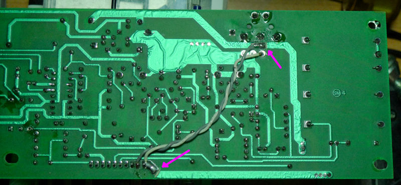

I also wanted to show you the bottom side of the Big Briar PWB:
Two more cuts in the PWB power traces at the arrows, and heavy gauge jumper wiring - from the factory?  Also, look at the strange puckering of all the traces, I don't think I've ever seen anything like this on any PWB.  The top side traces look fine.  Weird.
