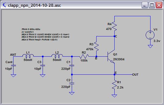

One thing that's been in the back of my head is using an NPN in lieu of a FET in the Theremin adapted Clapp oscillator. So while I should have been simulating the Moog electrically variable capacitor, that time was instead spent simulating and benching an NPN Clapp:
It oscillates around 130kHz (chokes I had laying around) with healthy measured antenna swing of over 80Vp-p, doesn't stall, and the output at the emitter is a complex wave at a lowish impedance. No idea of stability over temperature. No idea yet where the operating point should be, but maybe rather low to keep sensitivity low and playability high. No idea of linearity once heterodyned. No idea if ESD might be more of an issue with bipolar vs FET.
[EDIT] Spice file here:

That Clapp looks good - For direct analogue heterodyning the waveform on the emitter is important.. "complex" can be great, but it can also be horrible ;-)
As for ESD - I suspect the the bipolar will be more immune simply because R2 is larger than on a FET and theres low z on the base - but you will be having a discharge device on the antenna, so its moot - certainly from a construction perspective FETs are more risky.
42IF106 with all windings in series can go 698uH to 1.5mH .. I am inclined to thinking you may need to reduce L1 L2 a bit and up the frequency a tad to guarantee that the tuning will be adjustable over required range (whatever that is) to compensate for tolerances of L1 / L2.

"That Clapp looks good - For direct analogue heterodyning the waveform on the emitter is important.. "complex" can be great, but it can also be horrible ;-)" - FredM
Just added the Spice file to that post, the waveform I'm seeing on the scope is quite similar to what Spice shows. Rounded on the top, kind of a first premolar jaggy shape on the bottom. The top flattens out if you grasp the antenna.

That oscillator runs beautifully! I suspect the emitter waveforms into a multiplier (not a diode mixer) will sound great.
I am trying hard to stop myself from taking any kind of "role" here ;-) .. But if you are going analogue, then I think you might want higher frequency and padding with an antenna capacitor to reduce sensitivity.. This just is from my experience, and could be missing by miles as I dont have any 'reasons' that explain it really - but it seems to me that "uncorrected" low frequency oscillators end up giving worse linearity than "uncorrected" higher frequency oscillators..
But I dont think your Clapp will do well with the kind of Ls and Cs required to raise the frequency and 'pad' the antenna in this way - the antenna voltage kind of depends (?) on big L into small C - which is how you get away with such minuscule currents.
Not sure how you plan to "adjust for best linearity" - Without any "active" correction, the only mechanisms I can see as possible are series capacitance to antenna for minor near-field improvement, and oscillator coupling for far-field improvement... Or an antenna curved towards the player! ;-) .. A 45 degree angled 1 meter length antenna with its base at the shoulder height of the thereminist will probably do the job! ;-)
But as I say, I dont know why there seems to be improvement for linearity (but never good linearity) for simpler designs when the frequency is higher .. The SC/Jaycars for example have better linearity than they should have AFAICS, and better linearity than I have got from anything running below about 400kHz without equalizing of some kind... But the TVoX does it, so its not impossible!

Oh, BTW - Both inductors are essential on that Clapp?
