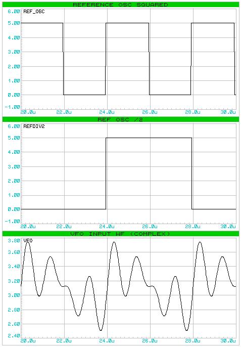

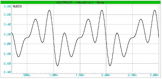

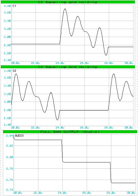

Now - IF your ADC were able to grab a sample quickly enough, then whatever waveform appeared on the VFO input would appear, at the difference frequency, on the output...

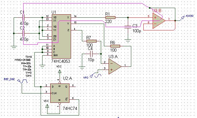

But hey - thats what I did! - and I didnt need an ADC! - And I got slammed by you for producing a system far simpler and better than your half-baked idea! - And I published the idea in complete form, with full schematics and description and waveforms clearly and unambiguously in a way that anyone can follow and use and build! .. And I did this before anyone had ever even mentioned anything similar, let alone published anything similar!.. So go chew on your sour grapes!
- I can have analogue oscillators which couple to each other if I wanted, square up the reference oscillator to drive the sampling, and grab the synced (distorted) VFO waveform.. On the sample 'playback' compress the waveform to achieve the identical effect of two oscillators being heterodyned.. But I also have total control of the waveform simply by changing the VFO shape.. And I can use analogue oscillators which track each other avoiding thermal drift problems, and produce whatever waveforms I want - "artificially" created, "naturally" created, or created by additive analogue synthesis...
