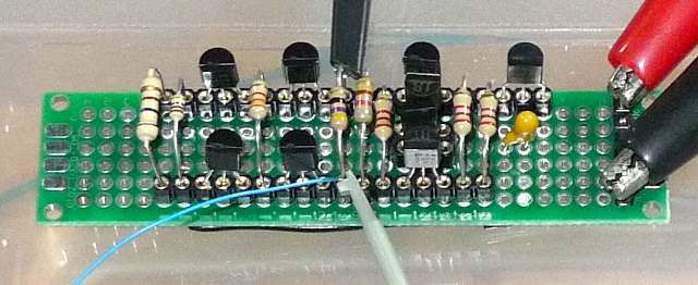

Posted: 1/16/2021 7:29:38 PM
8 Transistor ECL-LC Oscillator : The Vectoring
OK, finally got the oscillator on proper vectorboard:

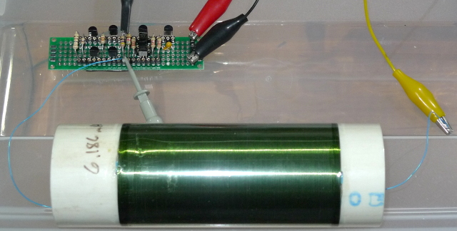

And here it is connected to a 6mH coil:
With 3.3V regulator it's drawing 6.75mA, 220Vpp at antenna, 592kHz.  When I power it down the frequency just barely budges as it flatlines, really amazing.  Difficult to stall w/ insulated rod antenna, no starting issues.  Still seeing the pinging / ringing described above.  My 4 xistor buffer is boffo!  (It's a subsection of an audio amplifier I designed and built for an EE lab assignment in college.)
Posted: 1/28/2021 11:25:17 AM
Ringing Source Found
It's my fluorescent desk lamp.  Turn it off and the oscillator waveforms are smooth as glass.  The bursts are at ~23us intervals, which is ~43kHz.  So it's not some random internal instability.  This is a great little oscillator, I turn it on most days just to watch it run for a couple of hours.

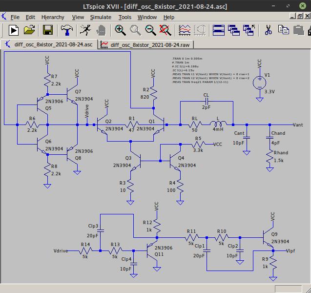

Posted: 9/15/2021 8:51:02 PM
10 Transistor ECL LC OSC
Been kicking this around in my head and in LTSpice for a bit:
It's just the 8 transistor oscillator described above with a 4th order low pass filter on the output.  The filter is for anti-aliasing before sharpening up the edges and digitally sampling.  Like the oscillator, the output is centered about VCC but only swings within a diode drop of each rail.  Haven't actually built it, so caveat emptor [LTSpice].
Posted: 9/16/2021 6:17:08 AM
Buggins
From: Theremin Motherland
Joined: 3/16/2017
Dewster,
Why is LP filter needed? Is Vlpf intended to be used directly by digital part or some buffer is supposed to be used? Are you sure driving of buffer (e.g. 1g04) from LP filter would give any advantages comparing to direct feeding of drive signal to buffer?
BTW, delay between inductor current and drive signal is 15ns - seems good enough.
Posted: 9/16/2021 5:50:53 PM
"Why is LP filter needed? Is Vlpf intended to be used directly by digital part or some buffer is supposed to be used? Are you sure driving of buffer (e.g. 1g04) from LP filter would give any advantages comparing to direct feeding of drive signal to buffer?"  - Buggins
My theory is when you square up the oscillator drive you're sort of sampling it and therefore "baking in" any higher frequency noise (~aliasing).  Also, it's probably desirable to band limit the signal going back to the processor board, and square it up there if necessary.
[EDIT] My ill-fated AFE did the XOR-ing in 74AHC logic, which considerably raised the bandwidth requirements of the cabling back to the FPGA, so I'm rather gun shy of any excess bandwidth anywhere.  Interference & noise should be dealt with as much as possible before non-linearities are introduced.

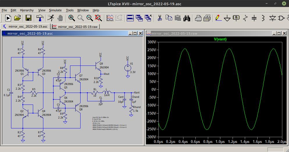

Posted: 5/19/2022 8:10:37 PM
Current Mirror Oscillator
Another variation on Vadim's fascinating oscillator:
It simulates real nice.  I had high hopes for it, but doesn't perform so well on the bench and needs a fair amount of capacitance to work - I think it's the phase error that's partly to blame.  Really low current draw, like a few mA (sim shows more).
Spice file here: https://www.mediafire.com/file/grs6ravndg0fnlt/mirror_osc_2022-05-19.asc/file
