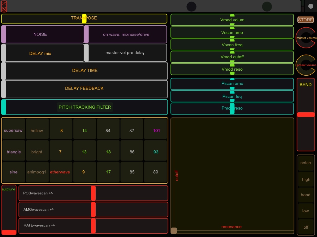

i like „touchOSC“, one edits the surface on a computer, and loads very easy onto the ipad/iphone. a bit limited on the functions, but works and looks very nice. especially a useful multi-button surface for wave-selection can be made easily.

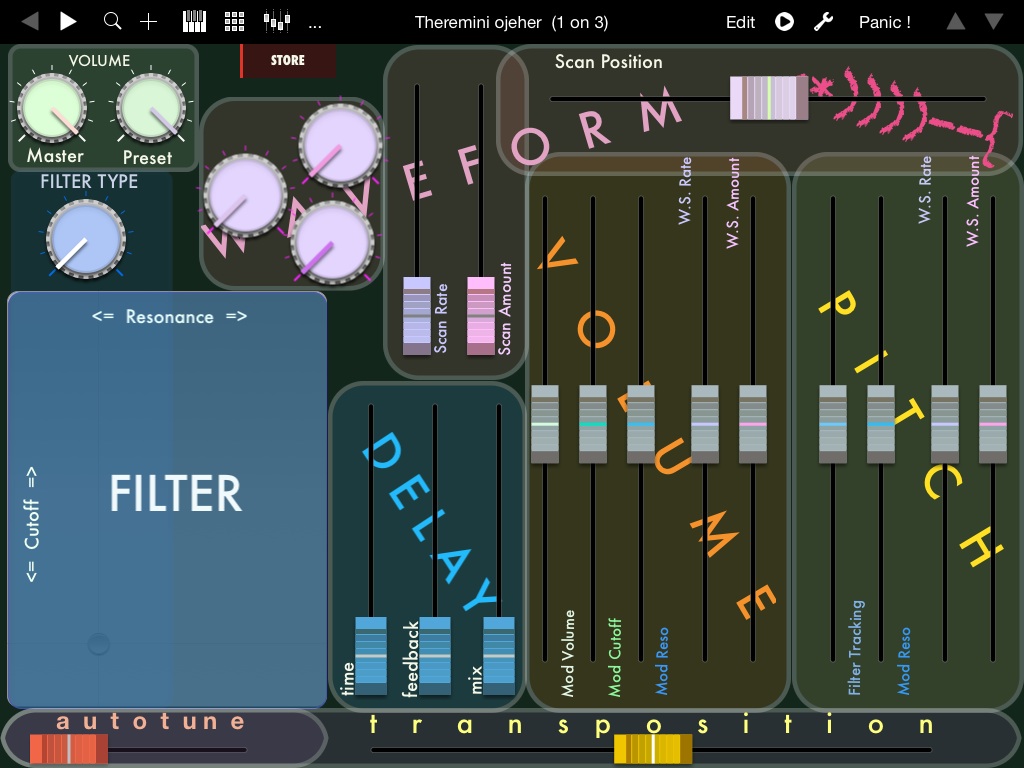

finally, i used : „TB midi Stuff“. does not come free, but still very low priced, for what it’s able a real bargain. one can edit sliders, knobs and all twiddel-dees ,all in the app and a quite easy to handle editor. may it finally look like touchosc or moog vintage synth, it’s up to you.
if one has deeper knowledge of midi, sysex etc. i think it would be possible to build a editor like the one from moog with displays,leds, knobs.. whatever. i made some basic surfaces for my own amusement, not the best and a bit over-colored maybe, to try it out and i have to say: they work as they should. like „faders“, but with the labels i like, and much much more sliders on one page. some send only limited values, like for the filter. on my surface, the sliders just send, so they don’t show the actual value of the theremini. it’s still work in progress, putting all on some logic, ergonomic place and setting things up, needs some efforts and time, but i’ve got my own controller!

fertig. Edit, well a tiny one : below left is made with toucOsc , the others with tbmidi stuff.
