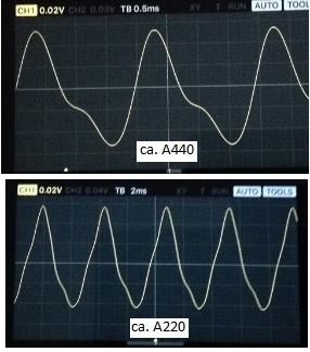

Let's look at the waveforms:
Here's one shot at about A=440 and an octave lower A=220 (note the sampling is different so they are not scaled visually as I think I had an autoscale on in one case). As expected there is not a lot of "edge sharpness" to it to create a buzzing sound.

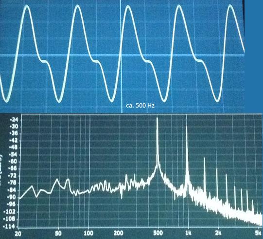

Here's another go at around 500Hz with the accompanying FFT plot. Waveforms with the iphone shift around a bit and but the general shape is there in both sets. And the theremin sound is not totally static. But the Burns has very little of that "buzzing" theremin character some instruments have by nature or can be applied with tone/filtering dials.
Burns Pro 500Hz with FFT
The FFT is interesting. Basically from the 500Hz fundamental it, rolls off with descending amplitude every multiple of the fundamental (500Hz, 1000Hz, 1500Hz, 2000Hz, 2500Hz, etc). So we're seeing a waveform with even and odd harmonics descending in a rather proportional way through the first 7-8 overtones. The first overtone also appears to get stronger as the fundamental increases which can be seen in the 220Hz FFT below (though I need to do more samples to confirm this but this does seem to indicate that the harmonic content changes perceptibly as the tones get higher and of course it is a little more gutsy in the lower register). So The Burns has a sound that should be rather faithfully reproduced by a wave table constructed by adding the first 8 harmonics in an amplitude shape per the FFT. But the key thing is I want to compare this more sine-like tone with the theremins that produce a much more raspy/gutsy sound.

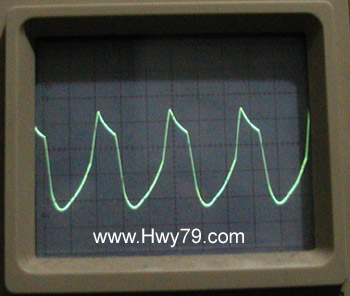

For example, compare this to the wonderful sound "Old Temecula" achieves with his tube-based creation that tries to emulate "Clara's sound". That sharp edge there makes all the difference. I just love the sound he gets here. See the following thread:
Finding Clara's Voice
Christopher's "Clara's Voice"
Christopher - can you set this wave to a static fixed tone around 500Hz and post an FFT plot?

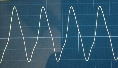

Now lets look a bit at the Etherwave which has Waveform and Brightness controls so you can get a variety of sounds from the instrument from more sine-like to more gritty (this is not with Thierry's module).
Etherwave Sine-like Setting
With all knobs left the Etherwave can get a mellow sine-like sound very similar to the Burns Pro - though the overtones appear to be much more pronounced on the Etherwave. Here we get a waveform and FFT very similar to the Burns though more overtones seem to be emphasized in the plot. This is even more evident when we dial up a grittier sound with the waveform and brightness knobs moving to the right.
