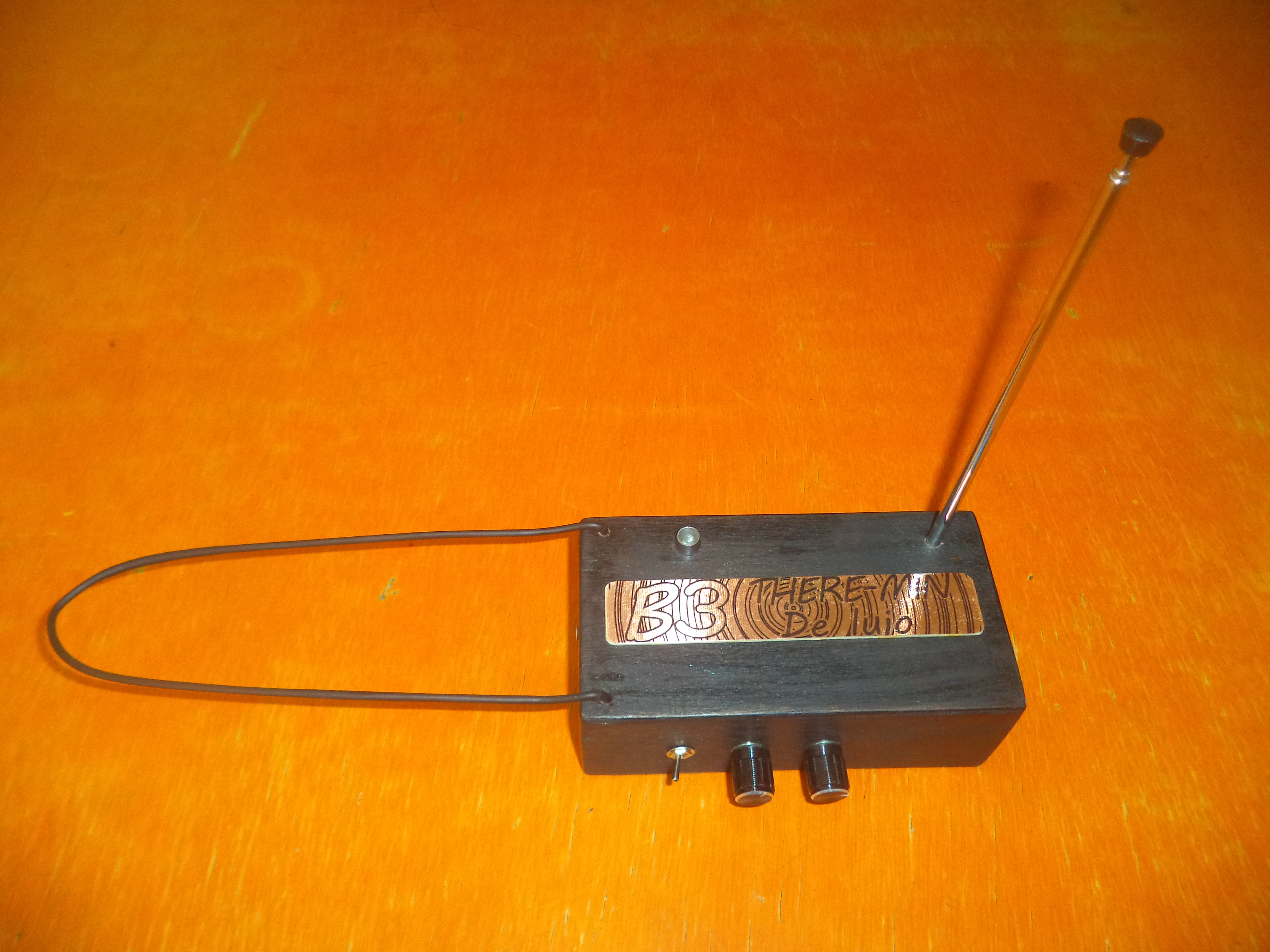

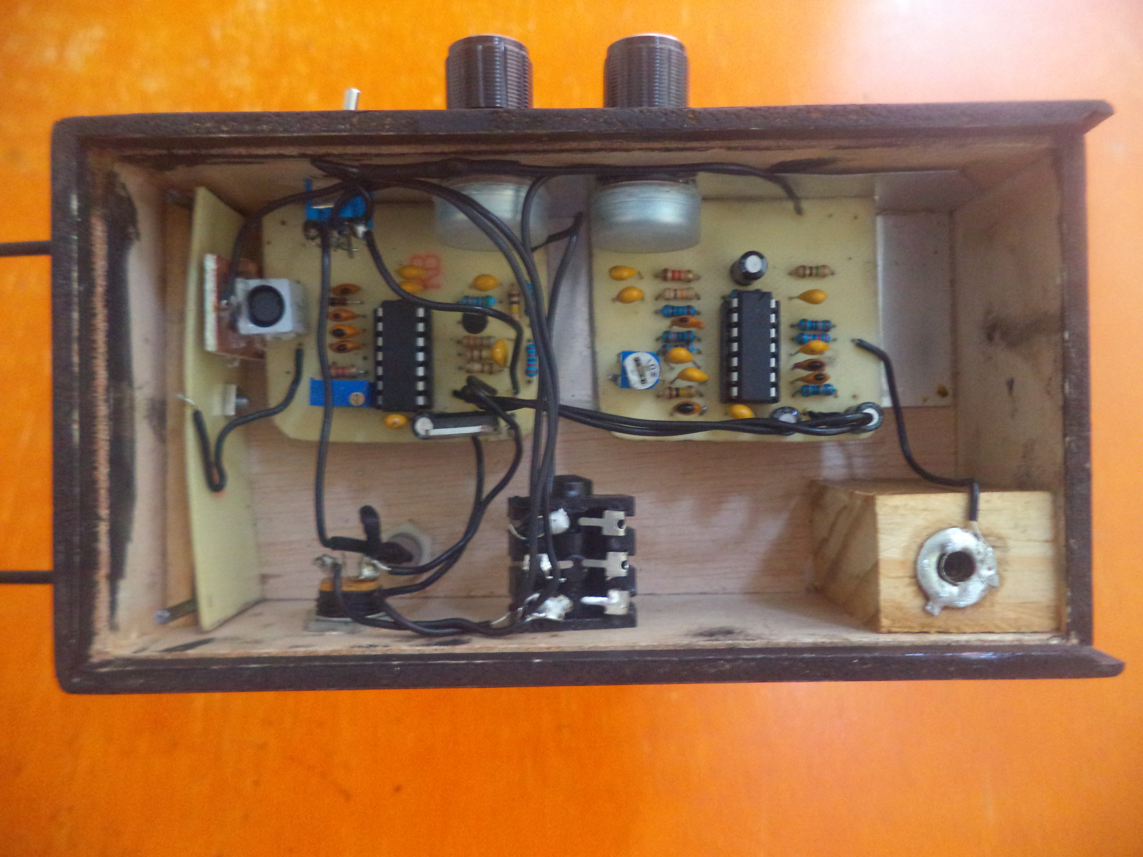

Here my replica, quite simple, in a mini box.
Saludos.

Pedro, very nice work on your replica!
What is the lowest pitch you can produce?  I found that using the same IC package for both pitch oscillators led to injection locking at a higher frequency than I wanted.  It was better to use an extra 4069 for one of them.  (I've been meaning to try 7555s, but haven't gotten around to it.)
Did you end up using CD4069UB parts instead of the CD4069C shown on your schematic?
