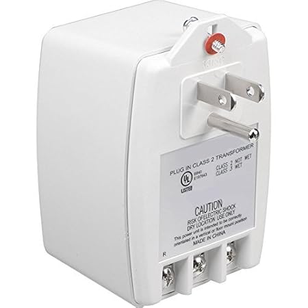

I do not want to redirect anyones build but you must adapt to what is available. I like this $16 12vac transformer here in the states.
Could 12vac effectively drive 12 volt regulators in your application I am not sure, 17 volt peak or 15 volt overhead average? It's close.
