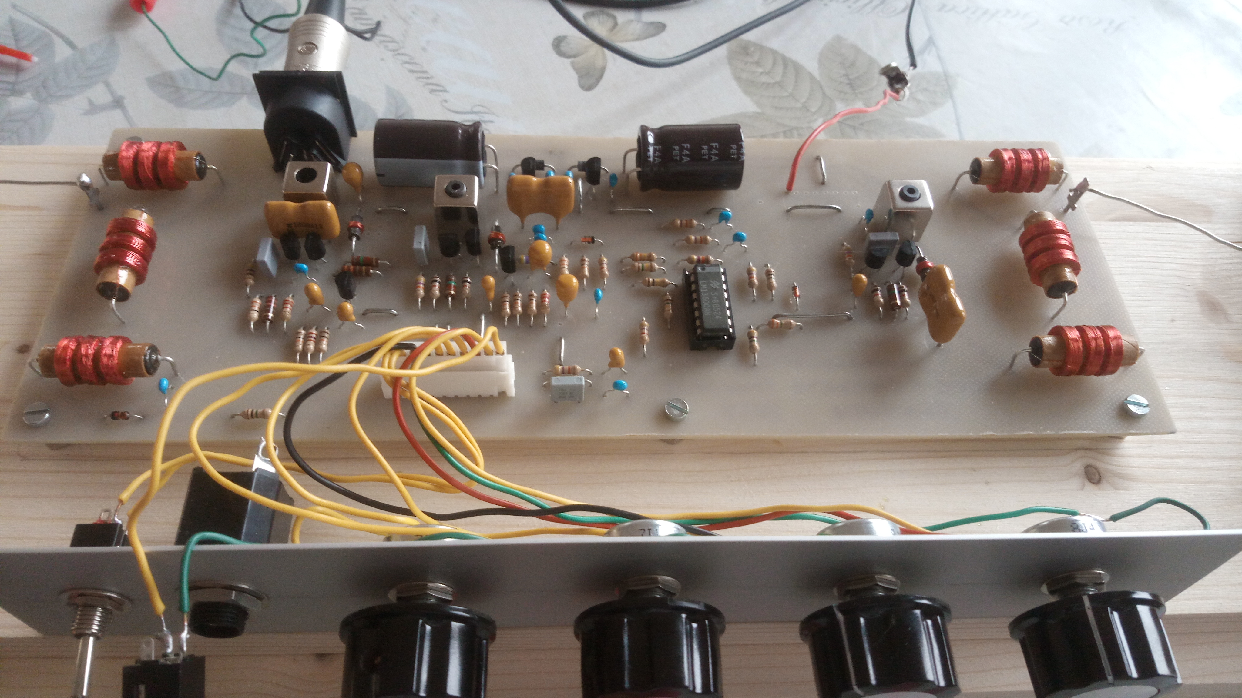

Thank you for posting this fine work, Gianluca. How is the grounding made here? Would you give us some sound examples? I wished my manual skills were almost as good...

Hi JPascal I am glad you like it, I temporarily use the radiator as ground mass using a small non-amplified speaker but I purchased the ultratone kt108 amplifier that I am waiting for and I have yet to understand what type of support to buy and finally make the correct calibration.
when everything is ok post some audio files.

Looks like a nice clean build!
