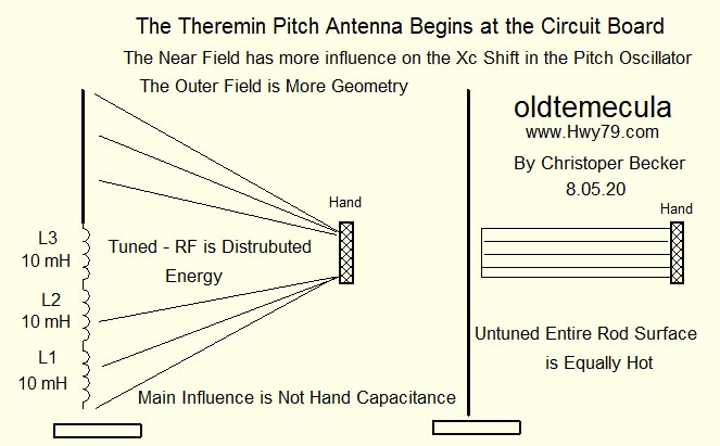

My observation in Analog Theremins is that ideal linearity is a natural tuning phenomenon in how radio frequency energy leaves the pitch antenna. Observing those neon plasma glass globes reveals exactly what is going on. Touch your finger to the globe is the same as touching the Pitch Antenna.

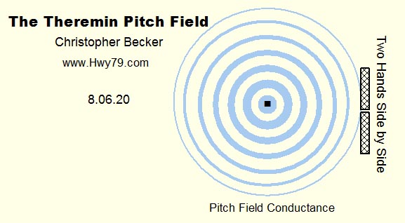

Early on I referred to this as Radiation Resistance and it upset the digital people so I changed my term to Pitch Field Conductance. This is why playing bare foot or well earth grounded stretches the pitch field musical note spacing. The capacitive loop concept is cute but makes little sense. When you say no earth ground is necessary I do agree with you but for different reasons. RF will still find a way to escape the source controlled or not.
We talk about hand capacitance but the energy flowing in the pitch field is still reactive RF field something the digital people do not grasp so do not mention in conversation. RF is the elephant in the room along with the changing reactance in the tank circuit. Yes this change is extremely small but that is part of the theremin phenomenon.
Linear is the best word I know of for what we are talking in the musical note spread, it does not have to be perfect, Thereminist adapt. The goal after the ideal response is understood is that all theremins should one day have this same theremin pitch field response from model to model. This way muscle memory can be fine tuned which is what every Thereminist is searching for along with a better sound or even their own sound. It is better to demonstrate than throw around lame mathematical equations all day.
The Moog E-pro and the Becker Electrodeum meet this requirement. In my video this is why Master Thereminist Valery Shamarin of St Petersburg Russia adapted so quickly to the pitch field right out of the packing box.
