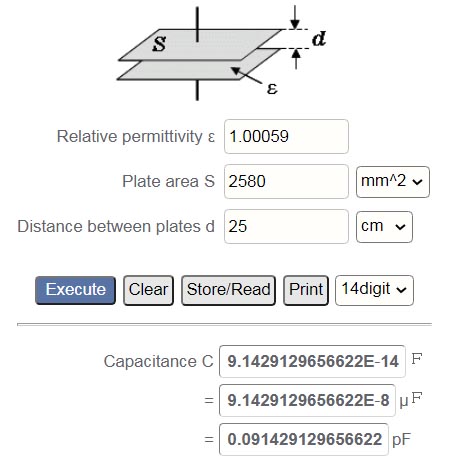

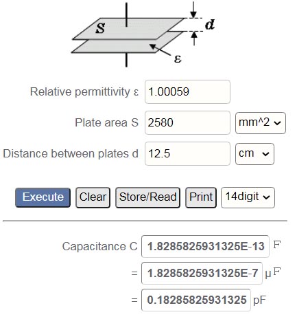

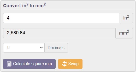

Posted: 8/13/2020 10:38:03 PM
Many points:
1. A 4" square is ~10,000 mm^2, so you're off by two orders of magnitude.
2. The simplistic formula used in that calculator is for mutual C only.
3. The Theremin LC "sees" total C, which is intrinsic C + mutual C.
4. Intrinsic C is between the antenna and the universe.
5. Mutual C obviously obviously increases as the hand approaches the antenna.
6. However, intrinsic C actually decreases as the hand approaches the antenna (FEA shows this).
7. Mutual C increases faster than intrinsic C decreases, so total C increases.
8. Total C is nuanced, you have to use finite element analysis (FEA) to model it with any fidelity.
9. Modeling data can be checked with real data, such as from ILYA's automated measurement setup.
10. Once the mathematical model is validated, one can test all sorts of antenna geometries fairly painlessly.
11. Models are simplifications - this is generally a feature, and not a bug.
When dealing with anything complex, having the model more or less match reality means you can probably trust it to build further understanding on.

This is the kind of exchange as a student I like. I was never the brightest bulb in the room. Pitt do you still live on Duluth, my metaphysical friends tell me you will be experiencing "severe" thunder storms.
Calculated Theory is .1828pf - .0914pf range of 5" to 10" = 0 to .0914pf added to the tank circuit
At 286,000 hz the added change of .0914 pf is = 0 to 50 Hz audio freq change?
At 923,510 hz the added change of .0914 pf is 0 to 470 Hz audio freq change even more interesting?
Maybe i got the decimal misplaced?  My Calculator
Edit The pictures have been re-posted

Posted: 8/14/2020 6:06:39 PM
"The way I see it the plate size formulas seem to work at a specific frequency and not equally across the 100 kHz to 1 MHz spectrum? You throw in all these variables trying to justify why the formulas you use do not seem to fully work."  - oldtemecula
Skin effect could creep and cause some differences in I suppose, but the C response will largely be the same over that frequency range.
Plate formulae only addresses mutual C, and otherwise are too simplistic to use when, say, researching Theremin linearity.  "That Glasgow paper" came up with a very hand-wavy formula - and lacking anything better I ended up relying on it for way too long.  Obtaining real data between my own hand and various antennas finally nailed this down for me.  Performing the "Capactive Clara" Fastcap FEA simulations gave me a deeper understanding of intrinsic vs. mutual that I don't believe is obtainable via physical measurements, and also provided finer differentiation regarding sensitivity and linearity among antenna geometries.  This is a non-trivial problem, there is a lot to learn here, and TW is the place to learn it.  I think one could take the data and come up with a closed form approximation, which would be nice, but it isn't essential in order to use the data directly.  One can work the data backwards through the LC and come up with the total C that the antenna "sees" for that data set, then play with various LC circuit topologies, EQ inductors, etc.
