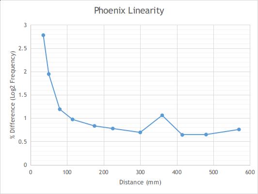

Ideal linearity comes about when the Antenna/Electrode resonates at the Pitch Oscillator frequency. With an un-tuned theremin Pitch Rod, lack of linearity will hinder your efforts to learn and be almost musically unplayable. In other words it will most likely be a waste of time to learn any real skill from an un-tuned Pitch Antenna. This makes the EtherWave Standard an excellent choice.
Maximum Pitch Field reach of six ideal octaves with ideal linearity is possible if the tuned RF energy on the Pitch Antenna/Electrode is maximum using the highest Pitch Oscillator RF frequency and earth ground, the Thereminist barefoot does make sense. This may seem like a capacitive loop but more is going on; it is the better conductive RF Pitch Field.
With ideal linearity the note positioning relative to one another remains the same no matter how wide a Pitch Field is stretched.
Keeping the above in mind six octaves at 4” or 10 cm spacing of Ideal Linearity can easily be played over a 24” or 61 cm Pitch Field, no octave switch or unnatural octave switching necessary.
