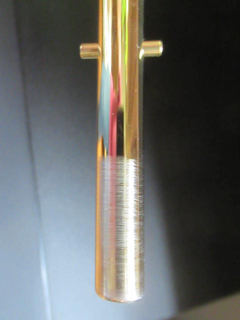

Over on FB, Lorenz Fish posted an image of his Cvox volume loop straight from the factory (hope he doesn't mind my posting it here):
Kinda amateur looking over-the-top sanding job, but I guess at this point they're leaving nothing to chance.  Soon they'll probably be sanding the whole thing down to a little scratchy brass nub, and you'll have to play it like a Melodia.
There are disturbing complaints of excessive pitch drift from folks who know their Theremins, and this is perhaps the most serious issue (so far) as it is likely a structural problem with the basic design, and not just a stupid SW bug that someone may (or may not!) fix.

Soon they'll probably be sanding the whole thing down to a little scratchy brass nub, and you'll have to play it like a Melodia.There are disturbing complaints of excessive pitch drift from folks who know their Theremins, and this is perhaps the most serious issue (so far) as it is likely a structural problem with the basic design, and not just a stupid SW bug that someone may (or may not!) fix.
Wow! Looks like they’re now using a sandblaster on it!  Perhaps a steamroller will be used for the next “fix!”

A brand new Claravox #832 arrived today as a replacement for my defective #40. It appears to be fully functional. The antenna was sanded down from the factory as depicted above. Subjectively the wood work seems to be of higher quality, with better fitment.
It still chirps when touching the volume antenna, but far less pronounced than the #40.
