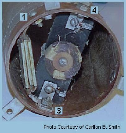

Posted: 2/8/2013 12:38:58 PM
Here is a photo: (from Art Harrisons report)
RCA Concentrating coil
So I would imagine coupling is loose..
But - Its sure not easy to visualize what (if anything) is really going on with regard to the effect of this coil and its position / construction.. To me, it brings more puzzlement than answers..
We have an antenna-side air coil with its low capacitance.. Feeding that, via a big capacitor, we have this little (probably quite high inductance - I do not trust any of the figures given) multi-layer coil with a screw of some sort in its core.. if this screw is iron, this will have a big effect on the coils inductance and probably on its coupling.. But at this point I am way out of my depth.
You see, to me, a screw (of any metal composition) looks like folly - it will have some effect on the inductance - and this effect will be temperature dependent - Its got to be worse than the temperature issues one has from a good ferrite I would think...
But this was designed by Lev, the RCA's dont (AFAIK) drift.. But a lot of care was taken by Lev (and those constructing his theremins) to compensate temperature variations by doing select-on-test capacitor swapping...
Posted: 2/8/2013 2:46:59 PM
Chobbs
From: Brooklyn,NY
Joined: 12/1/2009
the screw is nickel plated brass- like all the other RCA hardware.   This screw is just holding the coil to the wood plate inside the large coil.  it should be about 20mH.  Mine (from the radiola 60 is 18mH ) -
Also FYI-  brass screw vs steel screw vs no screw  makes no measurable difference here-   I recently changed this coil on mine after meeting with Mike Buffington.   I had previously been using something else for the concentrating coil and he recommended using  the one left over from the from the #60 carcass- which as far as i understand -is the same coils as the #1264 (only with an added center tap)....-  Anyway -I could not find any brass hardware,  only.... "gulp" - stainless.   I 'knew' this was a no-no  but out of desperation i tried it anyway, and hooked up my inductance  meter to quantize the damage.   Steel screw or no steel screw, the measured inductance didnt budge! **    I recon that this is because it is wound on a 1/2" form and the #6 machine screw has about 1/4" of air between it and the windings.
**ill bet that it probably did increase slightly- but was under the range of my scope and well within the tolerance of the component.
I'd assume that the dual coil construction is basically just to 'add them up' and achieve the desired inductance range.   For what ever reason a 50-60 mH air coil would be unpractical(...obviously it wold too large and unruly  but also maybe coil winding mechanisms could only handle up to 3" forms and 12.5" lengths?)
I havent done this on my RCA-  (tried it on the kep   tho)...but   Id be willing to bet that if one would replace the large-original antenna coils with some small bourns 63xx's in series-  equaling the proper inductance value(50-60mH)- there would be little or no noticeable change on linearity or range.
Posted: 2/8/2013 5:52:50 PM
Hi Charlie,
"the screw is nickel plated brass- like all the other RCA hardware.   This screw is just holding the coil to the wood plate inside the large coil.  it should be about 20mH.  Mine (from the radiola 60 is 18mH ) -"
Actually, Brass should / will change the inductance.. It is a metal commonly used in unductor tuning slugs  .. GOOD stainless steel probably has less effect.. ;-) AFAIK, brass reduces the inductance.
But whatever - I suspect that Brass is a lot more stable than iron when it comes to temperature.
Thanks for the info though - It a bit dissapointing, would love to find that the coil was optimally placed and had a specifically selected screw which did something brilliant like focussing the magnetic fields or compensating for temperature.. But perhaps I need to check my faith impulses, and remind myself that Lev was probably not an ET, LOL ;-)
.. I do still have a nagging doubt .. Why go to all the trouble of constructing a shelf inside the antenna coil, if the concentrator coil could have been simply mounted on the chassis beneath it?

I believe nickel is ferromagnetic.  Reading on-line, brass may contain some nickel and may be paramagnetic or diamagnetic.  (This is what kills me about "magnetic thereapy" - oxygenated blood is actually slightly repelled by magnets, and the "refrigerator magnets" generally employed have essentially zero penetrating power - lose/lose.)
".. I do still have a nagging doubt .. Why go to all the trouble of constructing a shelf inside the antenna coil, if the concentrator coil could have been simply mounted on the chassis beneath it?"  - FredM
I suppose so you get some flux coupling?  It might be physically easier to mount the inner transformer & capacitor there than anywhere else, and the slight magnetic coupling might have some benefit (if the windings are correctly oriented).  The photo you posted above seems to show a weakly magnetically coupled auto transformer with capacitively coupled (?) windings.

"The photo you posted above seems to show a weakly magnetically coupled auto transformer with capacitively coupled (?) windings"
Its just an inductor, connected to the antenna coil by a capacitor - effectively this inductor is in series with the antenna coil... Not even sure if the assembly could be classed as an auto-transformer.. perhaps slight coupling which would give a slightly higher total inductance than if they were completely seperate, but it doesnt look like the coupling would be significant.
You are probably right - the placement and shelf is probably mainly for convienience - somewhere to tuck the coil so it didnt interact with anything else, and didnt take any chassis space.
