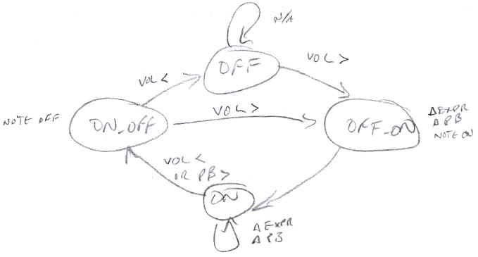

I've got an action plan, and not too surprisingly it boils down to more or less a pared-down version of the Open.Theremin approach - so very nice that their code is open source!
It's sort of a 4-state state machine, though only 2 states - the note on state and the note off state - can be entered @ IRQ; the other two states are transitional.
Starting at OFF we wait until the volume axis exceeds some threshold and then we transition to the OFF_ON state.
In the OFF_ON state we calculate the EXPR expression pedal and PB pitch bend values, transmit them if they have changed, transmit a MIDI note on, and then transition to the ON state - and then are done with a single IRQ's work.
Entering the ON state on the next IRQ we again calculate EXPR and PB and transmit them if there is any change.  If the volume axis drops below the threshold we transition to the ON_OFF state where upon a MIDI note off is transmitted, and we transition to the OFF state whereupon we are done with the IRQ.  A second trigger for the ON => ON_OFF state transition is when the pitch bend distance exceeds some agreed-upon (between MIDI TX and RX - manual settings) fixed amount such as +/-12 notes.  In that case we do ON => ON_OFF => OFF_ON => ON, which turns off the note, sends new EXPR & PB data, and starts a new note, finishing the IRQ.  This entire state transition transmits 15 bytes (I think we want to transmit 14 bit EXPR data rather than 7 bit data, and we can use MIDI "running status" to shave off the second status byte here) which takes 15 * 320us = 4.8ms, or a frequency of 208Hz.  Here's the breakdown:

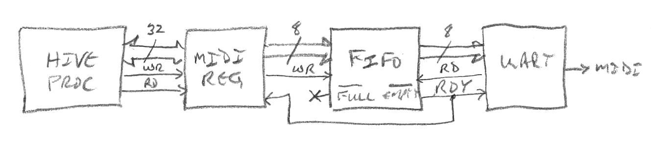

Plan B
After agonizing over the metering of MIDI data, I decided MIDI flooding is probably OK because the MIDI link is basically point to point with no merging going on (none at least at 31.25k Baud).  And then I hit on the idea of pulling the UART FIFO into this problem in order to make MIDI data clumps self-timing:
The processor MIDI interface is a register in the register set.  The register is a slave to the processor and a master to the write side of the FIFO it is connected to on the other side.  The read side of the FIFO is a slave to the MIDI UART.  Normally the FIFO write side full indicator is readable via the processor register, so the processor can know when it is OK / not OK to write so that no data is lost due to the buffer being full (back pressure).  I instead replaced this with FIFO read side not empty indicator.  There's no danger of writing too many bytes to the MIDI FIFO as it is quite deep (1k bytes) and our MIDI data clumps are quite shallow (15 bytes max).  So the new plan is to have the processor wait until the last byte in a clump is taken by the UART before writing another clump.  This required a bit of editing and a new FPGA load, but now the SW MIDI state machine can just hold off until the FIFO is empty, and doesn't require any sort of timer.  You don't want to calculate any MIDI data before you can transmit it, there's no point in a bunch of old data growing even staler in a deep FIFO.

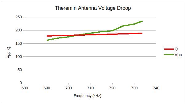

Just did a quick experiment measuring antenna voltage droop vs. calculated Q droop.
I was wondering if increasing C as the hand approaches the antenna could account for the quite noticeable antenna voltage swing droop.  Some equations for series LCR:
  F = 1/(2*pi*sqrt(L*C))
  C = (1/(2*pi*sqrt(L))^2
  Q = (1/R)*sqrt(L/C)
As usual the coil was a 3.826mH / 46.5DCR single layer solenoid driven by 8 xistor ECL_LC oscillator w/ 47 ohm output, connected to standard 3/8” antenna, home made HV probe.
Q is a direct voltage gain figure, but measured voltage droops much more than the series LCR equations back calculated Q.
Conclusion: hand/body R must be the dominant damping factor.
[EDIT] Further proof of the conclusion: I draped an insulated ground wire over the antenna and measured 220Vpp @ 690kHz.  With my hand I was getting 162Vpp @ 690kHz here.
[EDIT2] I probably wasn't clear enough in describing the mechanism under test here.  The third equation above shows that Q is directly proportional to the inverse square root of C, so as the hand approaches the antenna and C increases, we would expect Q to drop.  Which is does, but not at the much higher observed rate, which is due to the extra damping provided by what appears to be the resistance of the human body.  I suppose some of it could be RF emission as well, as the length of the human body would be a better RF radiator than a little (to the wavelength) rod or plate.

What if you didn't use your body-C, but a fixed capacitor to ground that has no R?
Posted: 3/19/2021 10:02:46 PM
"What if you didn't use your body-C, but a fixed capacitor to ground that has no R?"  - JPascal
That's effectively what I did with the draped ground wire, which exhibited much less droop at the same frequency.  I wonder if anyone has done a backward calculation to determine a rough human body series R (to use e.g. in oscillator Spice simulations)?
[EDIT] This is such an obvious basic experiment, I don't know why I didn't think to do it years ago.

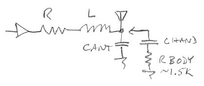

Damp Hands
In order to roughly model hand damping voltage droop, I just performed the following rather inexact experiment.  I grounded one test lead and clipped a resistor to it.  Then I clipped a second test lead to the other side of the resistor and draped this second test lead over the antenna.  I changed the resistor value until damping at 700kHz was roughly the same as my hand, which turned out to be 1.5k Ohms.  Testing different frequencies by increasing and decreasing the test lead coupling - and therefore the capacitance - revealed a fairly good correlation with my hand damping.
The above is what I'll be simulating with in the future, where R is the DCR + oscillator drive resistance.

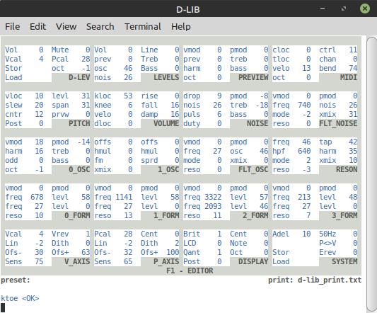

MIDI UI
Just updated the librarian, here's a screen shot:
At the upper right you can see the new MIDI UI page, which replaced the old PV_MOD page.
- CONTROLS -
cloc[0:63] : CC minimum value location [-48dB:0db] (volume axis).
ctrl[0:31] : CC control number (modulated by volume axis).
tloc[0:63] : Key-on/off location [-48dB:0db] (volume axis, with hysteresis).
chan[0:15] : MIDI Channel.
velo[0:31] : Key-on velocity scaling, 0 gives constant 64, 31 gives constant 127, values in between use volume hand velocity.
bend[0:127] : Pitch bend span (+/- half steps, e.g. 24 gives +/-2 octave PB span).
oct[-7:7] : Pitch octave offset.
For Theremin type playing I set ctrl=2 (breath) or ctrl=11 (expression pedal) and tloc < cloc so I don't hear the note-on event.  Also velo=31 to get full volume.  And bend=36 gives plenty of range before retriggering - I'm not hearing much in the way of pitch stepping even with absurdly high settings of bend, though I do hear some volume stepping depending on the preset and ctrl type.
I used my new-ish inverse scaling types for bend and cloc.  For bend I think it's maybe more obvious why: the larger the pitch bend range the lower the gain of pitch bend value.  For cloc you need to compress the control operation over a smaller range the higher the cloc setting.
This morning I was noticing lots of strange note retriggering at the on/off threshold.  I maxed out the hysteresis but it was still there.  Turns out the MIDI cable was running right by the volume plate and its ribbon cable, inducing fairly heinous interference.  Moved it a few inches away and everything's fine - whew!
