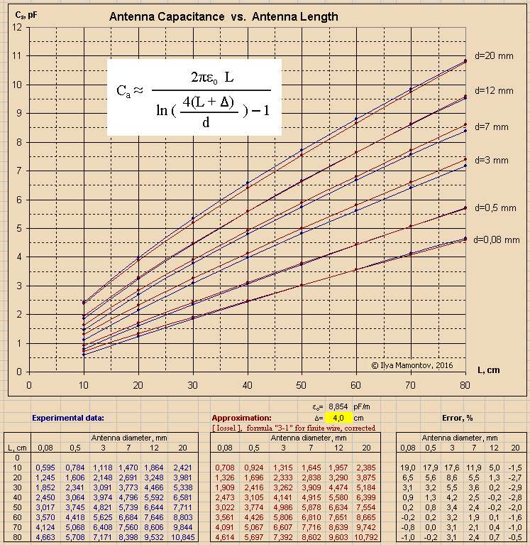

JPascal,
yes, there is a good accordance with the well known formula ("finite wire in free space").
With the additional member  Latin capital letter Delta.svg=0.04 m you will achieve the error less 5 % in range L= 30 to 80 cm.
But keep in mind that formulae are not doubly asymptotic: the behavor near zero point (L=0...d) is fairly abnormal. That's not so important, as I did not meet a theremin with antenna length 10 cm and less.

It seems to be very well. I suppose the correction value 4 cm is empiric. What if you'd use a corrected L* instead L (twice in the known formula) regarding the short connection wire from oscillator to the rod?

Yes, the value 4 cm was chosen in empirical way.
I played with the basic formula in different ways and the version above is a reasonable compromise *complexity vs inaccuracy*.
IMO there is no physical sense here. The antenna to oscillator wire has 2 cm length (approx.) and moreover, this extra (i.e. wire's) capacitance is eliminated by calibration.

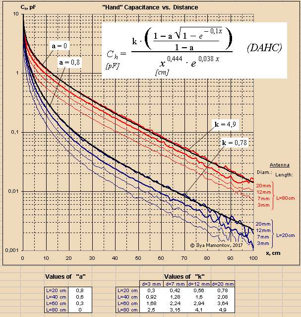

"I watched your interesting dispute with Dewster concerning the 1/d^x (x=1 or 1.7) dependence " -- JPascal
The relation kind of 1/x^1.7 was a first approach of weightlighter. It works satisfactorily just in a narrow range.
Now I have found another formula which gives an excelent approximation for antenna
length=80 cm. Plus, this formula is doubly asymptotic, i.e. it properly describes behavor near x=0 and at large distances (by members   x^0.444   and   e^0.038x   correspondently). Parameter k depends only on antenna length and diameter.
For short antennae, there is a discrepancy in crossover region (from function   1/x^0.444   to   1/e^0.038x). Sure, this situation can be corrected by unknown member "(?)".
Yes, I agree all this things are true just for a specific hand shape ("flat plate") and moving path, but it was necessary to begin with something.
Note. The distance "x" ("D") in model used is not a "true" distance. This is the path length across the arc. The value x=100 cm corresponds to angle 180 deg.

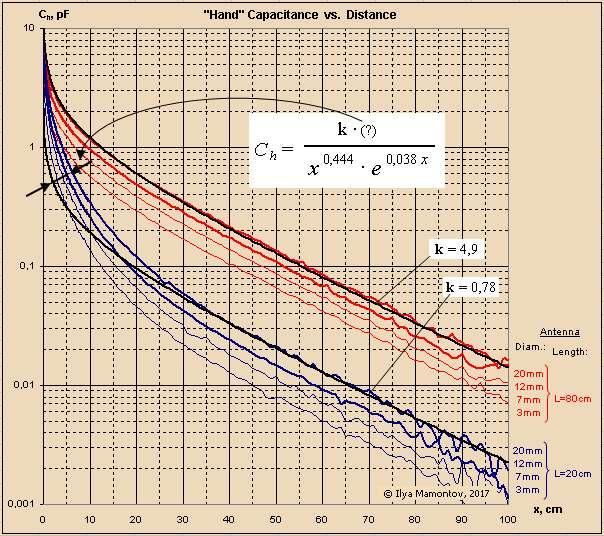

Posted: 12/11/2017 10:28:10 PM

ILYA, what about this additional part?

not good, because this way you change the slope of the graph.
All the curves have the same angle which is defined by "0.038x".
So only the 0.038, ne plous, ne moeins as is written on the Theremin's coat of arms.

The unknown member (?) can be calculated as follow:
DAHC formula (Doubly Asymptotic, Hand Capacitance)
Parameter "a" is choosen from 0 to 0.8 for given antenna length.
Tabulated values of k:
        d=3mm    d=7mm    d=12mm    d=20mm
L=20cm        0.3    0.42    0.56    0.78
L=40cm        0.92    1.28    1.6    2.08
L=60cm        1.68    2.24    2.94    3.64
L=80cm        2.5    3.15    4.1    4.9
